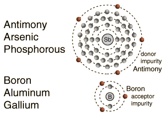

Well there are the Pentavalent impurities and well as the Trivalent impurities.
http://hyperphysics.phy-astr.gsu.edu/hbase/solids/dope.html
Edit: Oops. I read your post too fast missing your mentioning of Pentravalent impurities. Sorry. But for other readers, the link stands.
