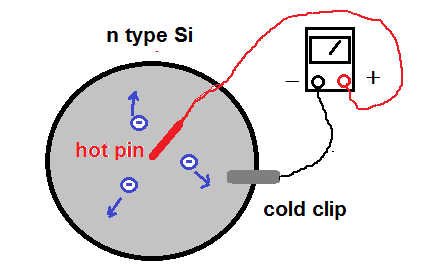

When working with semiconductors, I used a simple method to decide if a silicon slice was p type or n type. It worked by producing temperature gradient in the semiconductor wafer.(Wafers of several inches in diameter and 0.3-0.5 mm thick are available from the producers)
You need a sensitive multimeter or a galvanometer. Connect the wafer to the negative input of the meter, and add a pin to the other lead. Warm up the pin and touch it to the wafer.
The figure shows an n type Si, with electrons as free carriers. Near the hot pin, they gain higher velocity and diffuse away. The hot spot becomes positive with respect to the cold part and the pointer of the meter will deflect in positive direction.

I know of this technique but never found it reliable...getting good contact with the wafer was unpredictable and trying the probe over the surface can give conflicting readings. When working with semiconductor wafers I found gold wire probes to be most reliable ( most of this work was with gallium arsenide)

@lychette: It worked quite well with silicon.

OK...may be the way to go for moenste if all that is needed is 'identification'
