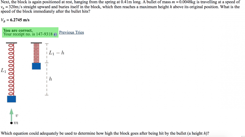

Which equation could adequately be used to determine how high the block goes after being hit by the bullet (a height h)? (see figure) (m+M)gh+ksh=1/2(m+M)V^2
(m+M)gh+1/2ksh^2=1/2(m+M)V^2
(m+M)v+ksh=(m+M)V
KE=1/2mv^2
Ugrav=Mgh
PE of spring = 1/2ks(s^2 final - s^2 initial)
Based off of the equations, I believe the answer should be the second equation. I don't understand what else it could be..

Some of the variables in those equations need to be definrd for us.
I see L1, m, v, and h in the figure.
What are k, s, M, V, an s without k ? Is that ks rather than k⋅s ?
Maybe you could explain why you think it couldn't be the other two equations you excluded?

Because the other two equations are missing components to their equations
ks = spring constant (k_s_)
(s^2 final - s^2 initial) = final stretch - initial stretch
v= velocity
m=mass1
M=mass2
And what components do these two equations have that are missing that the other one isn't?
(m+M)gh+ksh=1/2(m+M)V^2 the spring constant should be 1/2ksh^2 not ksh
(m+M)v+ksh=(m+M)V Ugrav should be (m+M)gh instead of velocity multiplying the masses (m+M)v, also (m+M)V is missing V^2
I think you have your answer then.
