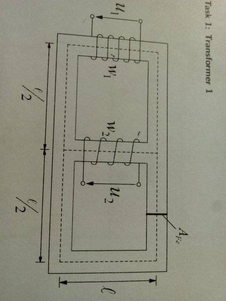

Which length has to be taken to compute magnetic resistance?

In general I read that:
[itex]R_m =\frac{l}{\mu A}[/itex]
But considering for example the following transformer:
I don't understand why the lengths taken from the sketch by the solution's procedure are the following:
For the right and left part resistance:
[itex]R_r = R_l = \frac{(\frac{1}{2} + \frac{1}{2} + 1 ) l}{\mu A} = \frac{2 l}{\mu A}[/itex]
For the middle part resistance:
[itex]R_m = \frac{l}{\mu A}[/itex]
So my question in general is: how should I measure the "l" in the general formula?
Place two nodes at the top/bottom of the middle part. Call them A and B.
The length of the path from A to B through the left and right part = 2 * l
Through the middle part the length = l
Very clear. Thanks!
