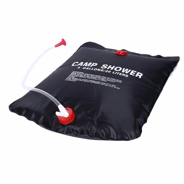

Do you know the colors of the cups? A black one will absorb sunlight faster than a white one, sometimes a transparent one faster still.
For example, camp showers like the one below are transparent on the front and black on the back to heat water as fast as possible.
-shower-bags-solar-outdoor-portable-thickening-water-bag-sun-shower-bags-20L-bathing-bag-Camping.jpg
  • -shower-bags-solar-outdoor-portable-thickening-water-bag-sun-shower-bags-20L-bathing-bag-Camping.jpg
Not if transparent both sides, surely? Something has to absorb the rays.
Yes. The black back face of the container. (A misunderstanding, I think) The transparent front bit will absorb and radiate less (none) and the backing can transfer more heat to the water and only a little to the surroundings. An outer insulating sheet behind the back would help further.

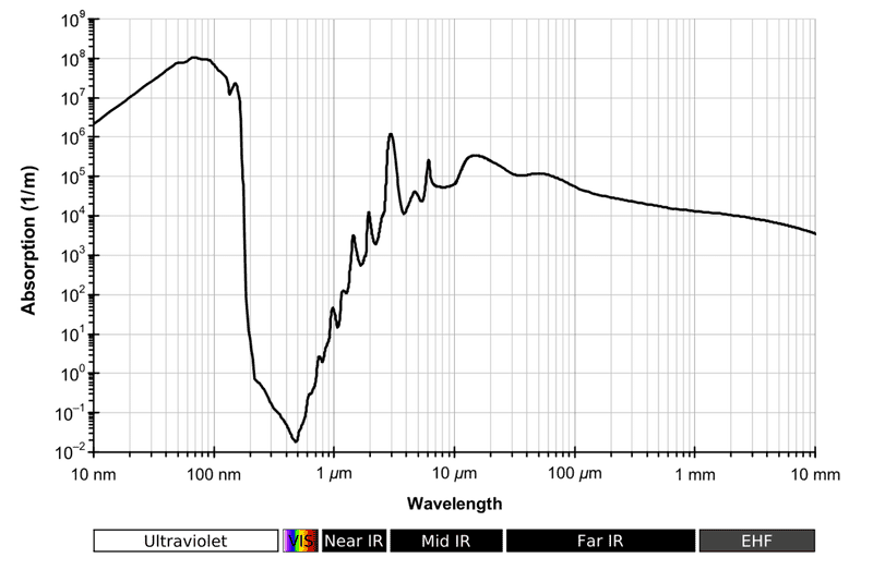

This curve may help explain. IR stands for infrared. Most heat in sunlight is in the infrared part of the spectrum.
[URL='http://By Kebes at English Wikipedia said:
Edit: Strange, you must click on that figure to see it full size.

glass (transparent) cup heated up fastest.
Sunlight is not just visible light. The infrared will be important too.
Water is opaque to IR. Some glasses block more IR than others; maybe the glass you used is fairly transparent to it.
