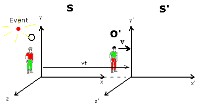

Hi,
Suppose O’ is moving forward with respect to O at speed v. A light behind him is switched on at t’ and x’ according to him (O’). x' is less than zero.
By using Lorentz transformation, we get that O will see the light before O’. Am I right?
Regards,

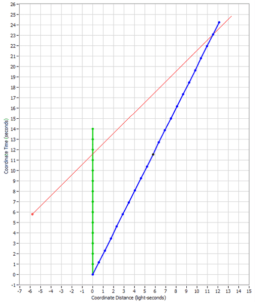

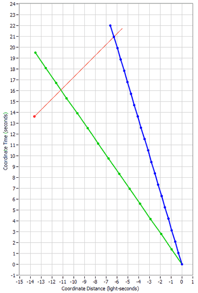

Here's a spacetime diagram depicting everything as I think you want it:
Observer O' is shown in blue and observer O in green. The light is shown in red. Note that O sees the light before O' sees it. Note the times according to their own clocks (the dots represent 1-second intervals of time). O sees it at his own time of about 11.6 seconds and O' sees it at his own time of 20 seconds.
powermind said:
If the time takes 10s according to the frame O’ after the coincidence, the time according to the frame O will take λt' = 11.54700538s.
This isn't correct. You neglected to use the x' value of -10 light-seconds in your calculation. Here is the original spacetime diagram transformed to a speed of -0.5c, making it the rest frame of observer O:
As you can see the time the light turns on in the O frame is around 5.8 seconds and no where near 11 seconds.

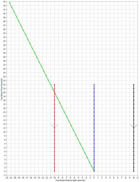

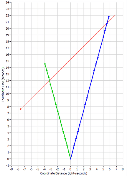

But, in the mean time, you should notice that the answer to your question of which observer will see the light first is the same in all frames. In both of the above frames, Observer O' sees the light at his time of 20 seconds and observer O sees it at his time of about 11.6 seconds.
Here is another frame where both observers are traveling at the same speed in opposite directions:
And another frame moving at -0.3c with respect to the original frame:
Note that each observer sees the light according to his own clock the same in all frames. Note that the light propagates at c in all frames. Note that the Coordinate Times and Distances are different in each frame.

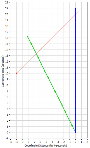

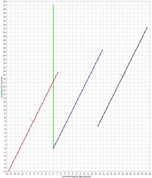

OK, so when you say "see", you don't mean when the light reaches an observer, you mean when the event of the light flash occurs according to an observer's frame. Then we only need to look at the first two diagrams that I provided you in post #13.
The first diagram is the rest frame of O' and the event (shown as a red dot) occurs at t'=10 (because you defined the problem that way) and you agree with this:
The second diagram is the rest frame of O and the event (still shown as a red dot) occurs at t=5.8s but you claim it occurs at 10γ which is 11.547s:
Since you "neglected to use the x' value of -10 light-seconds" then you didn't transform the event shown by the red dot. Instead you are transforming the event shown by the black dot in this diagram:
And it transforms to the rest frame for O as shown by the black dot in this diagram:
The black dot does have a Time Coordinate of t = 10γ = 11.547 seconds, but I don't see why you think this event fulfills your requirement.
I also don't see why if the time for O is 11.547 s and the time for O' is 10 s, you conclude that "observer O will see the light before O’ sees it". Isn't that backwards?
But even if it weren't backwards, I don't understand why you think you can neglect to use the x'-coordinate. Where'd you get that idea?

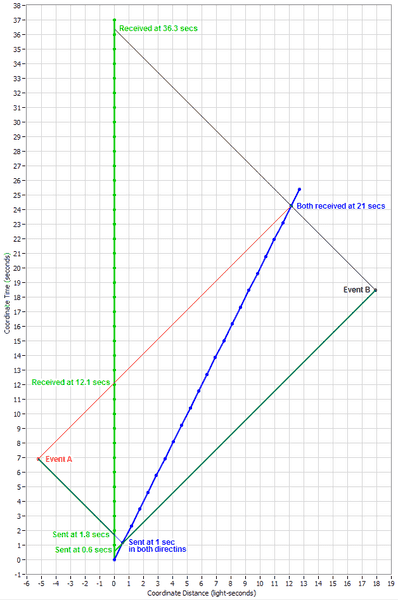

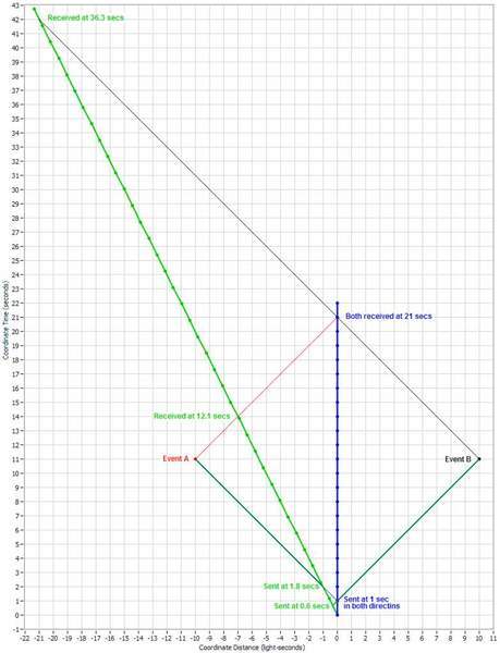

I will explain what my problem is.
Same example, let the event occur at t’ = 5s instead of 10s according to O'. If we apply the Lorentz transformation, the event will occur at t = 0s and x = -8.66 light-seconds according to O.
Now,
1- When the observer O and O’ are coincide, they reset their clock to zero.
2- So, the time (t) derived by Lorentz transformation should be read from the watch of the observer O after the reset. So how t=0s and may be less than zero although the event occurred after the reset of the clock of both observers!
What do these values mean or represent?
If two events occurred in frame O’, the Lorentz transformation can derive the time and location of each event according to O. what do the values represent?
See what I thought in more details:
Suppose two events A and B occur at the same time according to O’ after coinciding at t=t’=0. Let x’_a = -10 light-seconds, x’_b = 10 light-seconds, v = 0.5c. Then at t’=11s I will get t_a = 6.9s, x_a = -5.2 light-seconds, t_b = 18.48s and x_b = 18 light-seconds.
I thought that the observer O is reading clock from his watch starting from t=0s. When his clock points to 6.9s, the event A will occur and the distance between him and A is -5.2 light-seconds. Then he waits few seconds until his clock points to 18.48s. At this time, the event B will occur and the distance between him and B will be 18 light-seconds. Is this correct? Or am I wrong?

Ok, here's a spacetime diagram showing your original scenario with t'=11s for the two events. I have drawn in some radar signals that I will explain later (some of them show both blue and green emitted radar signals):
And here is the same scenario transformed to -0.5c:
Can you please help?
You are correct except that the blue observer O cannot tell when or how far away the events occurred in real time, that is, when they happened in his frame. Instead, he has to send radar signals that reflect off the events and he has to keep track of when he sent them and when he received their reflections and then he has to apply Einstein's convention for his rest frame that the time it took for the signal to get to the event equals the time it took for the reflection to get back to him. From this, he can calculate when the event occurred and how far away it was from him. If you look up at either of the two diagrams, you will see that whatever timings apply for the observers in one frame apply equally in the other frame.
Can you work out the details of how each observer calculates the time and distance to each event?
Can you see how they each arrive at a different set of values, even though they are applying the same process?

I have redrawn the previous spacetime diagram showing the two light bulbs at rest in the blue observer's O' frame. Note the two events marking when the lights are flashed on:
powermind said:
Because the frame O’ moves with speed 0.5c relative to the fame O, all fixed particles in the frame O’ such as lights A and B should move with the same speed relative to the frame O.
Correct, as shown here in the same scenario transformed into the rest frame of the green observer O:

It looks to me like you are concluding that if two elapsed times are equal in duration, then they represent simultaneous events. But as you can see by the second spacetime diagram above, the durations of the red and black worldlines that I have drawn in are equal in length but they are offset from each other. By making a set of radar measurements, the green observer O will be able to establish this offset.
In fact, if you look at the green observer's time of 15 seconds, he will be able to establish that a clock colocated with the red light is simultaneous at seven seconds after the red flash occurred and with a clock colocated with the black light at three seconds before the black flash will occur.
Simultaneity has nothing to do with durations, it only has to do with an instant of Coordinate Time for two separate events on different worldlines. If the two events have the same Coordinate Time in a particular IRF, then they are simultaneous in that IRF.
Once again, I want to applaud you for your mastery of the Lorentz Transformation. I think your only remaining problems are learning the particular jargon that is used in Special Relativity.
