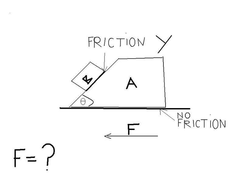

I'm a student at norwegian universety and I really have difficulty with phisics
Here's my question (look at attacment)
How big force F has to be so that B doestn't change position (doesn't flys over and doesn't fells down)?
Answer is this:
Mg(tanø*y) Mg(tanø+ y)
------------ < F< -----------
1+y*tanø 1-y*tanø
ø=angle
y=friction ( between A and B)
I'm not very proud to say that I used 10 hours in the row on this, so any help will be very appreciated!

Welcome to PF.
Consider then the forces acting on the block A, with mass call it m, along the plane of the incline.
Gravity wants it to slide down at m*g*sinθ
Friction wants to hold it at μ*m*g*cosθ
Now what about your force F ?
How much is it accelerating the system of A and B?
Then what components of that force are increasing friction? and what component is wanting to push it up the incline?
Hi! I am a newcomer too... So welcome:P
Where is the Force apllied? To the A body? To the B? To none of these?
