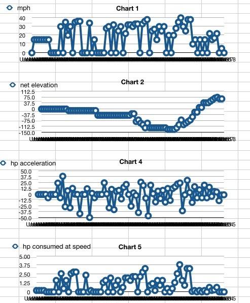

I performed this experiment on my last vehicle, where if I thought I was going to be sitting for at least 20 seconds, I shut off my engine. My starter lasted a week. It may have been a coincidence, but I don't think so. Starters on regular vehicles are simply not designed to start your engine every 5 minutes. Of course, if you doubt me, you are welcome to do the experiment yourself. My starter wasn't really that difficult to replace. And we can always use more data points. And just as a reference, the Charge Car data of my trip to work indicates that I stopped 20 times over the 10 mile distance.
It may have been Charge Car's analysis of the cost of my commute where I came up with my numbers yesterday. That was back in November of 2009, so my memory is a bit fuzzy.
Charge Car said:
Compute Cost of Trip:
Estimated miles per gallon of this vehicle: 30 mpg
Price of gas: $4/gallon
Price of electricity: $0.11/kWh
With this car, this trip will cost: $1.35
With an electric car, this trip will cost: $0.26
By using an electric car, you save: $1.09, a savings of 81%!
Of course, it's all theoretical.
One thing I find funny is to what extent some people will go to, to prove that electric vehicles are not a viable alternative. Charge Car requested people upload, from their GPS devices, the data from their trips to and from work. Check out this persons daily commute:
Trip Statistics:
Total Distance: 959.88 miles
Trip Duration: 20 hrs 28 mins 54 secs
Time Idle: 2 hrs 28 mins 35 secs
Net Elevation Change: 4.69 feet
Average Speed: 35.96 mph
Max Speed: 81.31 mph
He doesn't need an EV, nor even an ICE. That dude need a nuclear reactor!
I'm curious what he does for a living(newspaper route for the entire state?), and how much a year he spends on amphetamines and coffee.
