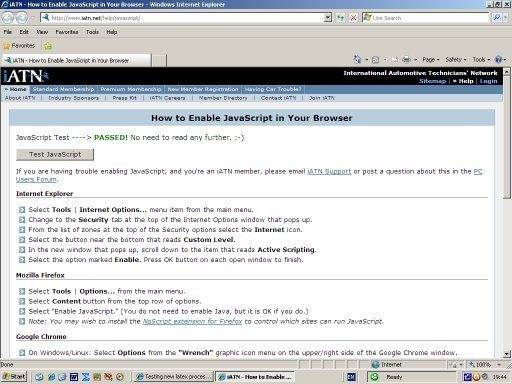

I've used firefox and IE, and for some reason latex isn't converting for me. I only see the tags and what you type.
do you have JS security settings that are maybe affecting it? any errors reported?
Not that I know of. Latex was working for me prior to this week and I didn't change any security settings. No errors either, I just literally see what the user is typing.
This site has switched to different LaTeX software (that's what this thread is about), so what was working a week ago may not be relevant. Check if Javascript is enabled (in your browser settings). Are you using a proxy? (If you're accessing this site from home, the answer is almost always no). Have you tried to just refresh the page?
