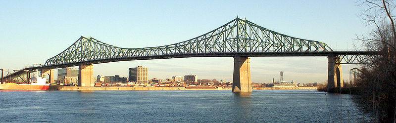

Here is a picture of the Jacques Cartier bridge in Montreal.
Would you call that a truss bridge or an arch bridge?
or the Chaotianmen Bridge in China
Note that what one considers the truss making up the arch is composed of triangles for both bridges.
The arch redistributes the loading to the piers.
