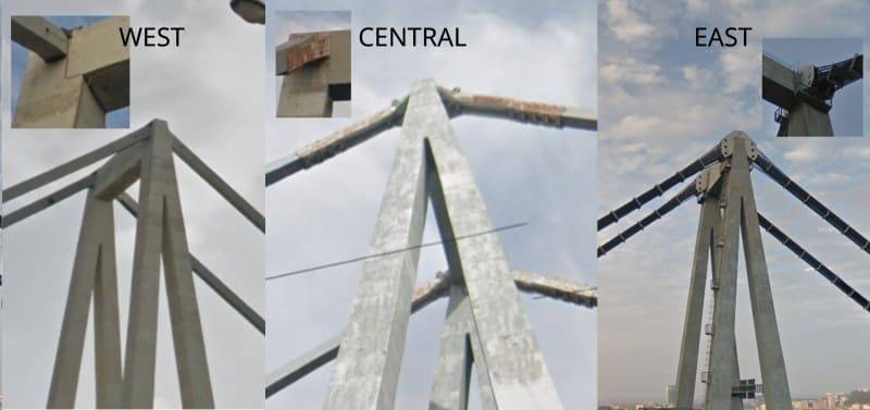

In the #4 post Wiki... site "Construction" section there is a photo that if you click on it, the last picture selection to the right shows in red what section of the bridge collapsed; and, apart of short tie-in sections at each end, all of components in that section (bridge & tower components),other than the cables, are loaded in compression.
Yes, in the section titled "Construction" there is a picture, if you click on that picture, it will open to larger view of that picture with an arrow on the left and right side, if you click on the arrow on the right side twice you will see the picture with the red area.

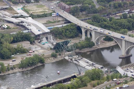

While speculation is a natural consequence of disasters such as this, we must remember that only the final analysis counts. I am reminded of the Infamous Tacoma Bridge collapse and how for decades afterward people described the collapse as a consequence of harmonic vibration.
However more modern analysis revealed it to be something more insidious.
https://motherboard.vice.com/en_us/article/kb78w3/the-myth-of-galloping-gertie

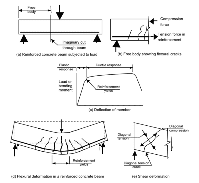

Baluncore said:
I want to know how we can make bridges that fail gradually by plastic deformation, rather than by a catastrophic collapse?
Can a redundant structure allow a significant deflection, one that clearly indicates an approach to failure, but which somehow strengthens the structure as deflection increases.
Normal procedure for designing reinforced concrete is to design for ductile failure. A concrete beam without reinforcing steel (rebar) supported on simple supports at the ends and loaded in the middle will fail catastrophically when it fractures on the tension side. Adding a little (as in not enough) rebar on the tension side, and the beam will still fail catastrophically because the insufficient rebar will not be able to carry the entire load when the concrete cracks in tension. Adding more rebar (the right amount) to the tension side will transfer the load to the steel when the concrete cracks. The steel will yield without breaking. Adding too much steel to the tension side keep the tension steel from yielding until the compression side fails in brittle compression. Suddenly and catastrophically.
Reinforced concrete design is a complex specialty of its own. I designed a simple concrete slab once, and convinced myself to let real civil engineers do similar jobs in the future. Some good Google search terms: seismic design concrete.
Last week I was designing RC for use in the ground, under hydrostatic compression. Yesterday I was trying to counter that design with a plastic cellular box formation, the problem then becomes fire …
Yes, I know civil engineers like to use RC because it is cheap and acceptable, but even ignoring the carbon cost it has long passed the time when we should consider alternatives. I certainly do not advocate reinforced concrete for the design of slender bridge members.
To escape the RC paradigm of the last century, I want to consider other materials and other structures. I am thinking of hierarchical closed cell foam structures inside tensile tubes, think tapered members a bit like a bird's bones.
