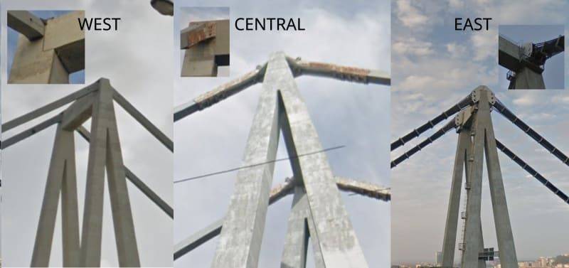

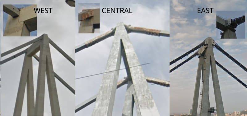

Somebody seems to have been worried over the years about the stay attachments.
https://www.eng-tips.com/viewthread.cfm?qid=443075

Indeed. Soon after the accident there was an article in the UK press that said that some of the stays had been reinforced but not those on the tower that collapsed.jim hardy said:Somebody seems to have been worried over the years about the stay attachments.

It's a few meg pdf file, and in Italian, but has interesting pictures during construction.
Those stay attachments were added sometime after 1968.
Which doesn't really mean a thing .
The stays themselves are encased in concrete that's why they're square. . I don't know what provisions there were for inspection.
There are in that document @nsaspook linked some pictures of them before the concrete cover was put on.
