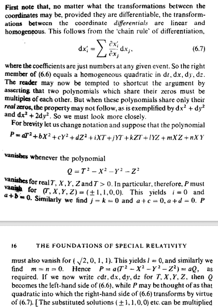

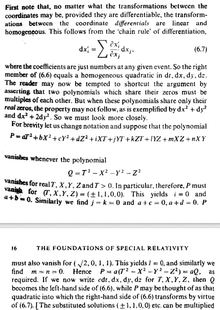

Sagittarius A-Star said:
On page 5 according to your screenshot you can conclude from the first sentence, that ##a## must be constant. L&L doesn't explain this, but in the 1960 book "Special Relativity" of Wolfgang Rindler, he did it in §8, page 16:
Hello!
I read about irreducible polynomials and constant factor between them but it was written that polynomials were depended of the same variables. For example, P(x) and Q(x), but in the case of the example we have two polynomial with different variables: P(dt, dx,dy,dz) and Q(dt',dx',dy',dz'). Why does it work in this case?
Thanks.
Mike_bb said:
Hello!
Thanks.
As written in the screenshot, this works because the transformation is linear. Therefore, you can re-write all primed variable in terms of the unprimed variables in the following way:
##t' = Ax+By+Cz+Dt## and so on. This means you can write both polynomials so, that they depend on the same variables.

I have this source only:
Scanned book page on special relativity, page 16, showing printed text and equations including dx'i = sum of (dx'i/dxj) dxj (6.7), polynomials P and Q, and handwritten annotations striking through some lines.
I can't give rigorous definition of the term "differential" because its depend on context.
