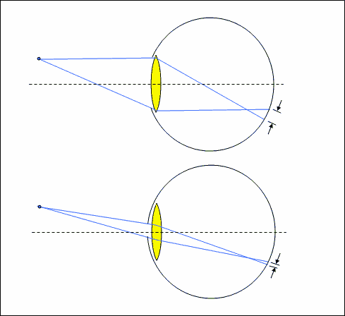

While reduced spherical aberrations play a role, a smaller aperture results in less blurring for objects that are not in focus. I hope this picture illustrates the effect clearly enough:
This is also why photographers use smaller apertures to get a larger depth of field, or large apertures for a narrow depth of field.
