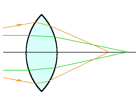

You are restricting the bundle of rays entering your eye, so you are using a smaller part of your lens. It more closely approximates the correct surface over a smaller area - it is the off axis rays that need to be bent to form an image.
You do the same thing with a camera - a sharper image is formed with a smaller iris aperture.
In this example, your imperfect eye produces a different image for two parts of the scene (orange and green rays), so giving you a blurred view - if you put an aperture (pinhole) in the way to block the orange ray you will only get the single green image.

Interesting - thank you! Also interesting there with the camera thing.
It's like if I look at an arrow, there is only one ray coming from the top of the arrow, and only one ray coming from the bottom of the arrow. This makes an image on my retina built up by dots that have a 1:1 relation with each dot on the real object. So when I take of my glasses and see a blurred image, it's actually because there are a lot of "redundant" rays that disturbs the image! I haven't thought about that before. :smile:
So, actually the pinhole doesn't make any bending!
