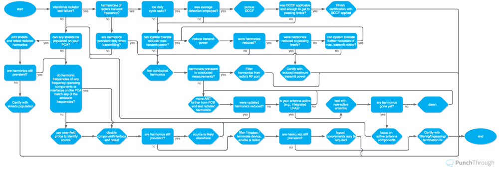

As you are no doubt aware, some of those phenomena could be due to harmonics ##-##
https://punchthrough.com/wp-content/uploads/2018/12/emissions-decisions.png

I'm not sure what you are getting at here. An ordinary mf AM receiver has a very narrow band reception bandwidth and good interference rejection. If it were subject to harmonic interference then it would soon find itself in the waste bin. Also, where are those harmonics generated? If you are suggesting that the transmitter could be to blame then it would fail the regs at installation. (Or are you referring to 'rusty bolts'?)
It's not clear what that fault chart refers to (it's too complex to read without any other help) but, if you put realistic figures in the boxes then, in the context of am broadcast transmitters and receivers, it's not really relevant.
In any case, second and third harmonics of an mf transmission still have huge wavelengths, compared with a typical hole in a hill.
Also, if you ever try to build yourself a Faraday Cage that actually does the job, the first thing you have to do is to eliminate all cracks and holes. There is actually no such thing as a hole that's "too small" to admit radiation. It's all a matter of how many dBs of rejection that's "enough" for the purpose.
