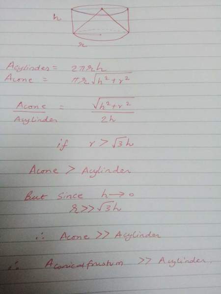

We know that we calculate the volume of sphere by taking infinitesimally small cylinders.
∫ ∏x^2dh
Limits are from R→0
x is the radius of any randomly chosen circle
dh is the height of the cylindrical volume.
x^2 + h^2 = R^2
So we will get 4/3∏R^3
Now the question is why cannot we obtain the SURFACE AREA using, infinitesimally small cylinders. Where
∫ 2∏xdh
Limits are from R→0
x^2 + h^2 = R^2.
I have a certain explanation for this which works well, but i would like to know if there is an unambiguous answer.
Thankyou :)
hi sahil_time! :smile:
sahil_time said:
… why cannot we obtain the SURFACE AREA using, infinitesimally small cylinders.
they're not cylinders, they're frustrums of a cone! :wink:

I would just like you to look at the attatchment, where I've tried to convince myself.
If we compute the surface area by using CYLINDERS we end up getting a LESSER area than 4∏R^2 .The reason why cylinders do not work, is because "for an infinitesimally small height dh" the area of the ACTUAL surface of the sphere (which represents a conical frustum, i have taken CONE in this case) will always be greater than the surface area of the CYLINDER enclosing it.
yes, that's correct, the frustrum area will always be more by a factor secθ, where θ is the half-angle of the cone …
(but your diagram doesn't really work, it needs to show a proper frustrum, rather than one that goes up to the apex of the cone :wink:)

yes, that's fine! :smile:
but you could shorten it by using θ from the start …
your first line could be Afrustrum = π(r1 + r2)secθ
and then show that the bracket = 2r1 as r1 - r2 -> 0 :wink:
