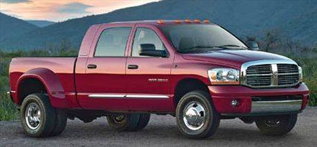

Why do rigs have their front wheel rims sticking out while other rims stick in?
http://www.discountramps.com/truck-wheel-risers-1.jpg
My first theory was that it allowed them to use a common axle length for all axles on a rig but subsequent observation reveals that that's not the truth. Front wheels and rear wheel are flush with the sides of the vehicle, meaning that the rear axles must be shorter (see diagram 1).
My second theory has to do with making room for the steering/pivoting bearing (which is unique to the front wheels). Having the rim stick way out allows the mechanism, and most importantly the actual pivot point, to be vertically over the contact point on the road (see diagram 2).
Am I close?

I've always just assumed that it's because both rear axles are dualies. The inner wheels and outer ones have their (flanges?) face-to-face for a solid connection.
That was one of my other theories. But look how far the front rim sticks out - several inches beyond the tire. If you placed another tire face-to-face with this one, there would be a gap of about six inches between the two tires, not the 1-2 inches I see with the rear tires.
You've got me there. While the ones in the photo are clearly intended to look good, I doubt that the shape is purely cosmetic. Maybe it does have something to do with the braking system or steering geometry after all.

How else could you mount a pair of dualies while minimizing the total width and mounting space? Also, this allows one to use the same rim for the inner and outer wheel.
It is done the same way for smaller trucks, but not so for truck running singles.
I'm still sayin' no. The front rims often stick out at least 4 inches beyond the tire. If they were using the same rims on the rear tires, there should be an 8 inch gap between the rear pair of tires.

Note that the inner rear wheels have to slide over the drum or they would stick out beyond the side of the vehicle. You also want to minimize the mechanical advantage between the drum and the outer edges of the tires.
Note that the torque acting on the studs due to the inner wheel cancels the torque due to the outer wheel. This way the bearings see a [mostly] vertical load, with no side loading.

The inner wheel and the outer wheel are not necessarily the same on the dually. I just measured and the distance between the sidewalls is about 3 inches on the rear duals. The reason they are not the same is simply because of looks. Why stick a shiny aluminum rim in behind where no one will see it? I measured the distance between the edge of the rim where the bead of the tire seats and the face of the rim where the other dual would set against and it is only 1.5 inches. This measurement was on the front and although it was too difficult to do on the rear I would estimate it is the same based on the cockeyed way I had to hold the tape measure. It probably has nothing to do with brakes since this setup was used long before semi tractors were required to have brakes on the front. It would have more to do with putting the steering pivot as close to directly above where the tire hits the road. This does have an advantage during braking too. If the steering pivot were more towards the center of the truck the wheels would want to pull back during braking and put unecessary stress on steering components.
There are limitations for the front, but the key question is why different rims are used on the rear when dualies are used. Again, without dualies, they generally use the same rims on the rear as the front wheels. The dual wheel configuration is independent of steering concerns.
