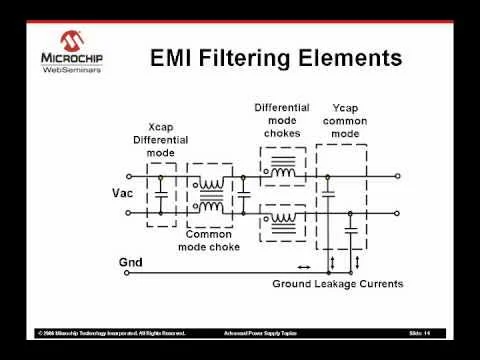

Due EMI reasons most appliance power supplies contains some symmetrical capacitors to the ground, or in absence of ground (double-insulated device) to the chassis:
In absence of ground this means the chassis will be on half-line voltage (high impedance source, not dangerous).
