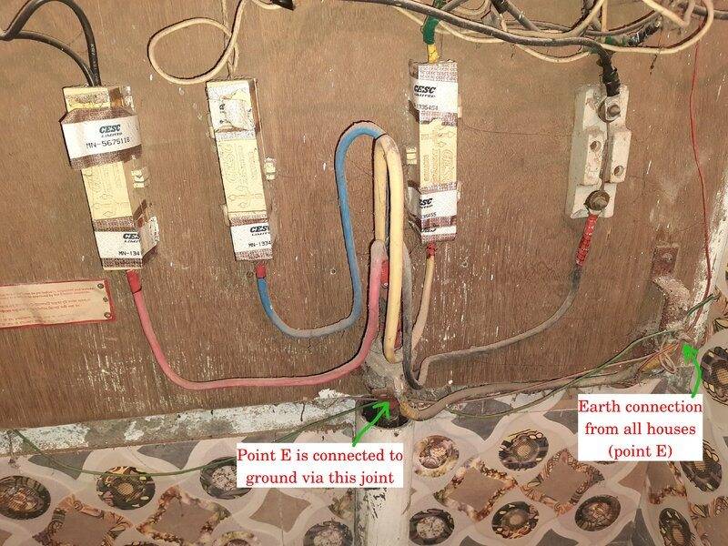

We are facing a severe earthing problem. In our house, the potential difference (PD) between neutral and earth is ## 50 - 60 ~\mathrm{VAC},## which should normally be ##< 2~\mathrm{VAC}## if earth is properly connected. I determined this with my multimeter after some appliances were giving electric shocks. And this value is approximately the same in all outlets inside our house.

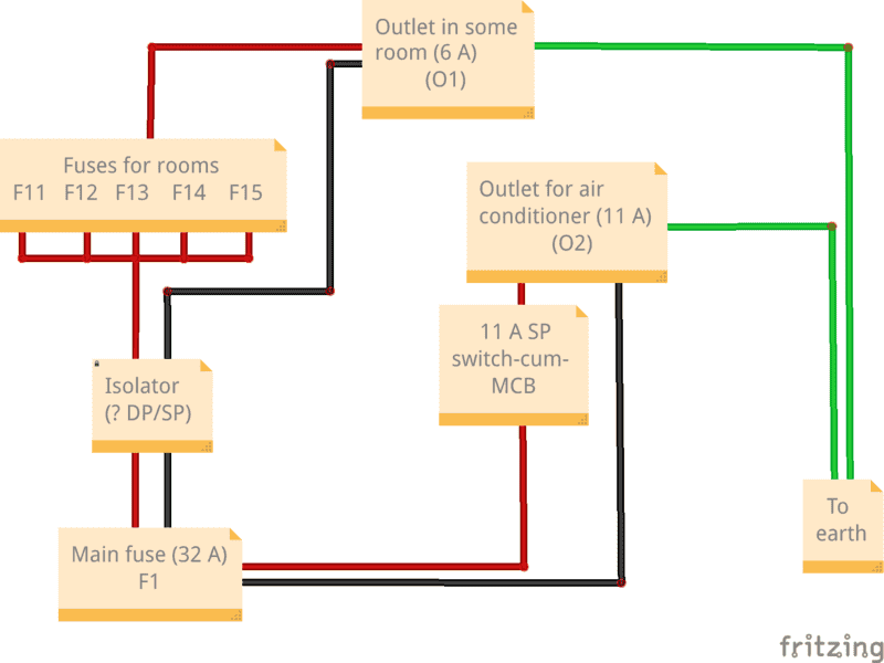

Now, I am trying to figure out whether the issue is only in our flat, or throughout the building.
Here is a diagram of the main circuit board in our building:
There are three lines (phases?) (red, blue, yellow) and a neutral (black) that enter the building. I have not shown the electricity meters, as they're not required. Also, the neutral wires from each fuse (F1-6) are actually separate wires that meet at the company fuse (point D) for the neutral line (similar to the earth wires, which meet only at E).

Our fuse box (F1) is made of metal, so the earthing wire that comes down from our flat is first connected to that metal box, and thereafter connected to point E. I also checked the PD b/w this box and point E, and it was ##\approx 1.5 - 2~\mathrm{VAC}.## It shows that earthing is fine at the main board, so something is wrong in the wires between our house and the main board. We shall be calling an electrician to rectify it.

What are the physical locations of points D and E (and how far apart)?
They are on the lowest row on the wooden board, in line with all the other company fuses, and maybe around 10 cm apart. E is vertically a bit below the line of the company fuses.

The first test I would do is to connect a 240V filament lamp between earth and neutral, then measure the voltage again.
1. If the breaker immediately cuts that circuit, then you have a good RCD breaker.
2. If the voltage then falls toward zero, you are missing your local ground to neutral link. Call an electrician to restore that link in your distribution box.
3. If the lamp glows red then wires are crossed in your vicinity, you have a problem that certainly needs an electrician to resolve the safety issue.

Here are some pictures of the setup:
The first three are the fuses of the three phases. Then comes the neutral. At the bottom right of the board, you can see the point where all the earth connections from different houses are joined. This is connected to the metal pipe via the thick black wire. The metal pipe houses the three phases and the neutral wires and runs underground. In this way, the company ensures that the earth wires are actually grounded.
The fuse in the neutral line.
Edit: Changed second picture to a better image.

This is what I did:
Inside our house, there is an isolator (not sure whether it is SP or DP), and after this, there are separate fuses of low rating for each room (or a set of rooms, sometimes). However, as per the standards, single high current lines (> 8 A) have to be directly drawn from the main circuit board downstairs. So, the wires to the outlet for our air conditioner is directly drawn from F1 and bypasses the isolator. It has a separate 11 A switch-cum-single pole MCB (similar to this, but with lower rating than the one linked). Therefore, switching off the isolator has no action on this outlet; it can only be switched off from F1.
I put the bulb b/w live and neutral neutral and earth in this outlet, and it was glowing with low brightness, as usual. Then, I switched off the isolator. (In this situation, the whole house has no power except that outlet, and no appliance is connected to that outlet, except the bulb.) The bulb flashed bright for a second, and then became dimmer, but still continued to glow. Switching on the isolator increased its brightness to what it was initially.
Let me know what this means.

I put the bulb b/w live and neutral in this outlet, and it was glowing with low brightness, as usual.
Live and neutral or live and earth?
Wrichik Basu said:
What exactly are the things I should note down? Only whether the bulb glows b/w neutral and earth (and whether it becomes dimmer or brighter)? Should I also note down multimeter readings?
Connect a filament lamp between Earth and Neutral.
Does the lamp glow ?
What is voltage across the lamp, before and after ?
Once you have performed that test, it will be possible to work out the next step in the search for what must be at least two faults.

The only 3-pin appliance currently working in our house is the refrigerator.
Here is a schematic of the circuit inside our house which will help understand the data I took.
Note that I am unsure whether the isolator is SP or DP. The refrigerator is connected through the isolator.
The data is summarized in the Google Sheet below:
What I can see:
  • When the compressor of the refrigerator is running, the difference between earth and neutral is greater than ##10-12~\mathrm{V}## compared to when it is not running.
  • However, the PD is almost the same when the refrigerator is unplugged vs. when the refrigerator is plugged in and the compressor is not running.
Can we infer that the refrigerator is not at fault here? What other conclusions can be drawn (in addition to the fact that the earthing is faulty, and needs to be rectified by an electrician)?

Lnewqban said:
You should not see any problem in your house if next door house is not powered, if our assumptions are correct.
No. You are ignoring the other houses at the other two phases. They can be equally culpable in backdriving, and can , in fact, be worse.
@Wrichik Basu Have you done the tests @Baluncore suggested? My working hypothesis is that the local Earthing network is not well connected to either Earth or Neutral. Then any faulty appliance in any house can create a serious problem for all.
Or spend your effort finding the best electrician you can , show him/her your diagram, and indicate you want an explanation of the problem when it figures out.
I am going to ignore this thread until the filament lamp test has been done.
Yes, please use the incandescent when doing tests.
Let's get back to the fact the that there is very little voltage between D and E in the first diagram you posted. The assumption is a poor connection in the earth conductor as you get away from what is point E in your diagram. I am going to stand by what I said in my first post about concerns whether the system exists as it is presented in the thread. No offense intended, mistakes happen. You may know that each earth pin is supposed to connect back to earth but do you really know the route? I would be familiar with how things are supposed to be done in the USA but what is the practice where you are at? In the USA the earth conductor is run in the same cable or raceway as the hot and neutral back to the source. If there is a broken earth wire in the raceway only devices downstream from that break will be affected. It's not spaghetti when done correctly. Based on your diagrams, I have to wonder about your system.
Troubleshooting 101: Find a place in the system where readings are correct and you understand them. Then move away from this point until the reading are incorrect.
