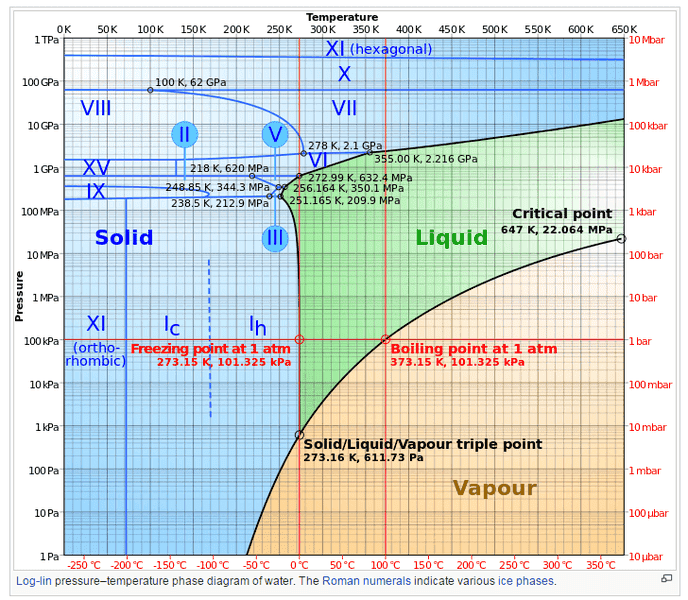

Liquid water can exist at -4C if you increase the pressure enough. See this phase diagram.
And, at a phase transition between liquid water and ice, liquid water and ice exist in equilibrium simultaneously.
I'm familiar with this, but I was assuming everyone understood me to mean -4 C and atm pressure. This entire conversation becomes trivial if we allow pressure to vary to let water thermodynamically favor liquid at -4 C and some P.
Sorry. I did not understand that. But this brings me back to multicomponent vs single component.
