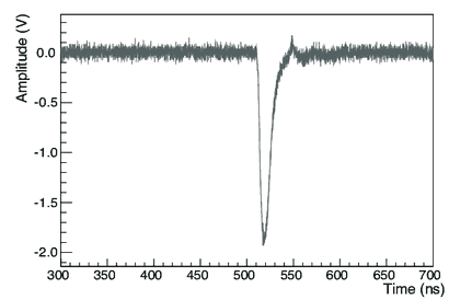

The standard output waveform of a photomultiplier tube has a "negative" pulse, like below. Why is the amplitude negative?
Example-of-an-acquired-waveform-of-the-PMT-output-and-the-electric-signal-induced-on-the.png
Show the surrounding circuitry.

And the electrons are negative !

I think @phinds was better. It's not impossible to design a circuit where the pulse is positive, even though the electrons are negative. A PMT is but one element in a circuit.
Agreed but, pour a load of electrons on something and its Potential will go in the negative direction. The OP was a bit too simple, of course, but electrons are at the coal face, here.

The conventional current flows from ground, down through the current to voltage resistor to the anode. That is why the pulse is negative.

But it does make a practical difference where ground potential is chosen. These were developed in the 1930's. I think I'll stick with door #1...

I have used a PMT tube with grounded cathode as part of a TV camera. But grounded cathode not useful for DC outputs referenced to ground.

As far as the negative signal, had it been positive and someone said, "oh, it's common to have an odd number of inverting amplifiers in the base", we all would have nodded sagely.

I took the clue for the 'no output' level of zero. The question wording refers to the tube itself afaics. It's clearly been connected into a circuit that establishes a bias voltage of 0V. Then, along come the negative charges.
