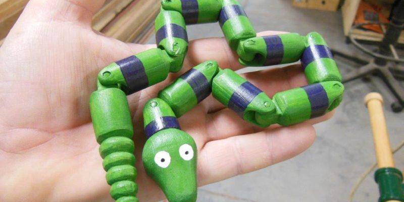

Do you know this toy? It can do both, behave like rope or like you describe, depending on how you hold it.
No sir I am not familiar with this.😅
Can you please give me some information fof this toy.
It was one I enjoyed as a kid. It's a snake, with single-axis joints between segments. So unlike a rope, it can sustain a force perpendicular to the rope -- but only on that axis. So when you hold it upright, it stands out horizontally, but when you rotate it 90 degrees, it falls down. Or to put it another way, if you hold it one way it is a rod and if you hold it another way it is a rope. But the reality is a rope and a rod differ only in degree of flexibility.

It's very simple, and the picture pretty much says it all. Russ wrote more above.
The key is: To lift all segments at the same level by holding one end, the joints have to transmit not only a force, but also a torque. In the case of the toy snake they can only do it on one axis. In the case of the rope on neither axis.
