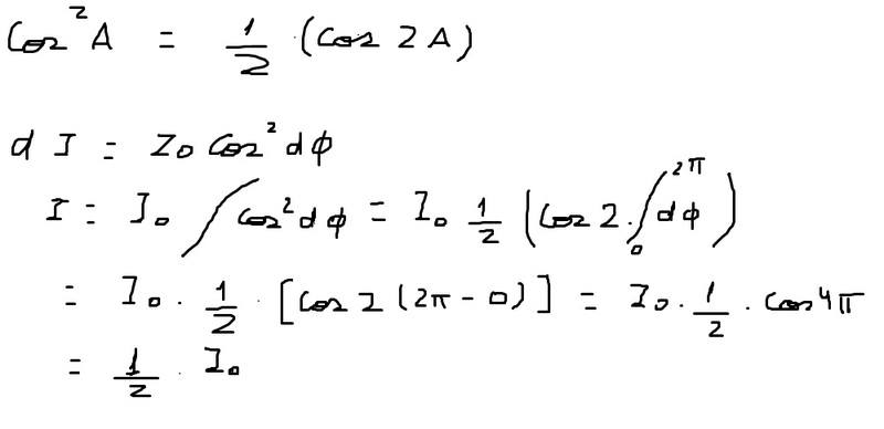

Ok, however, I find the same result by a different way:
dI = Io cos² dφ
I = Io0 cos² dφ = Io0 0.5 cos2φ = Io 0.5 (cos2 x 2π) - (cos2 x 0) = 0.5 Io
Is it correct?
Should be ##\cos^2 \phi ~d\phi##, and "cos2 x 2π" does not work (cosine of 2? or of 4 pi?), and there are missing brackets. The prefactor in the first equation is wrong and happens to cancel the integration problems in the second line.
Sorry, why should I use φ. dφ ?
I rewrite my expressions in the correct form:
$$\cos^2 A\neq \frac{1}{2} \cos(2A)$$
You are missing a constant there. Only this constant leads to a non-zero integral later, the cosine term doesn't contribute to the integral.
cos 2(2π-0)
I have no idea what you are doing here, but it is wrong.
so where I start to find this relationship
mfb said:
cos2ϕ dϕ
That is not a relationship, and the equation you posted was wrong in the first place, so I don't get the point of your question.
##\cos^2 (d\phi)## (what you posted earlier) does not make sense, that is not a proper integrand.
