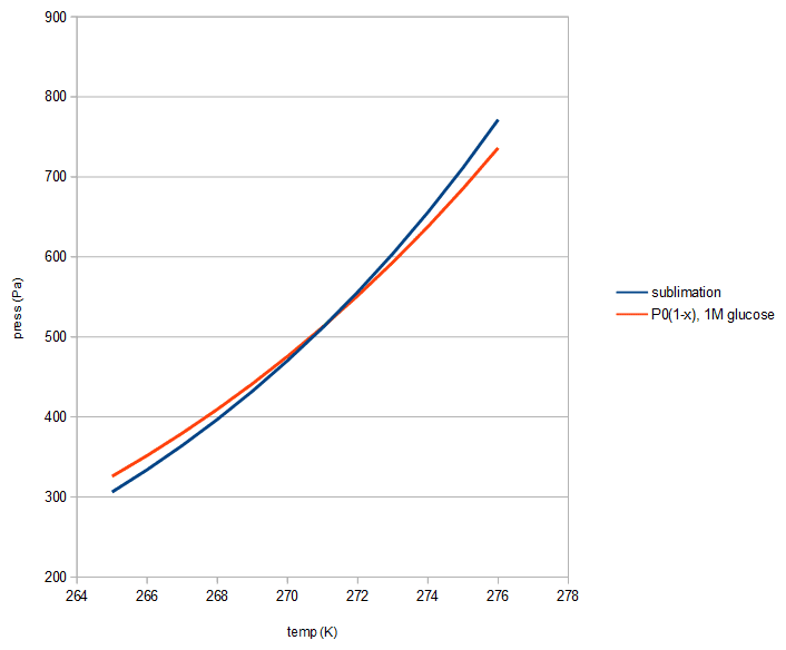

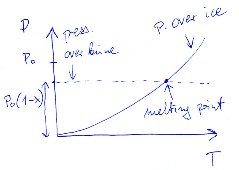

P0 is a function of temperature, pressure of the saturated vapor over ice changes with the temperature as well (although at a different speed).
Now, if you've cleared the above doubt, so how would freezing point decrease, you've explained till that if we keep ice and brine in a container, the ice would disappear, so what does that have to do with the decrease in freezing point?
If there is no ice, only brine, have you reached the melting point?
What happens to the pressure of the saturated vapor over the ice when you lower the temperature? Does it go up, or down? If it goes down - what will happen when it reaches the value given by the Raoult's law for the given brine concentration (and P0(T))?

When the temperature is lowered, kinetic energy of the molecules decreases so vapor pressure of the ice decreases.
If it reaches the value of P (which is the brine's vapor pressure), then it would coexist with the brine. But I've some doubts regarding this.
If the temperature is decreased, won't the pressure of the brine decrease too?
Also won't the Raoult's law prohibit these vapor pressures from becoming equal (like in the previous case) ?
