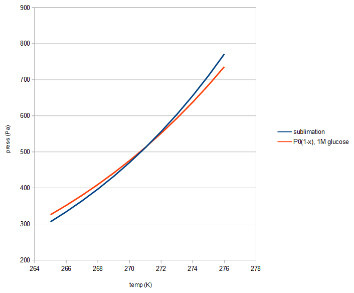

Looks good (unless I am missing something).
Line graph of vapour pressure in Pa against temperature in K from 264 to 278 K: a blue sublimation curve and a red P0(1-x), 1M glucose curve, rising together and crossing near 271 K.
This is calculated from Claussius-Clapeyron equation assuming P0=611 Pa (not exactly what we need, this is a triple point, but close enough), ΔHvap=45.05 kJ/mol, ΔHsub=51.06 kJ/mol, 1 molal glucose solution (better than brine, no need for Van 't Hoff factor) which has x=0.0177 (after taking into account solution density).
*I'll pretend that the we're still talking about brine rather than glucose, as I feel more comfortable about it*
From this graph, I see that the curve for the ice is steeper than the curve for brine, that means before the melting point is reached, the decrease in vapor pressure is more for the brine than for the ice(so I was wrong), then how can the two vapour pressures even become equal? I can't make heads or tails of it. Hope you see my confusion.
A confusing factor here is the failure to terminate the ice vapour pressure curve at 273,16 K.
Also, it would be illustrative to include the vapour pressure curve of pure (supercooled) water.
