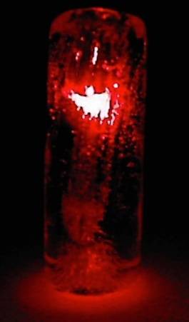

While checking my vacuumed water, I noticed that the core had not yet frozen.
OmCheeto said:
Creating a vacuum is easy. Proving you've created a vacuum, is hard.
Actually, I've just discovered, that it is not that difficult, to prove you have a vacuum.
Eureka!
Can't wait! Can't wait! Must publish! Must publish!
Oh yeah...
time for a cigarette...

That's a beauty OmCheeto! Even I tried it but could not get a perfect transparent crystal. I get that central mystical froth inside, and I believe it jutted out of the surface a few minutes later.. I wonder what that was.

I tried 3 different methods.
1. Tap water under a vacuum.
2. Previously frozen water at atmospheric pressure
3. Previously boiled water at atmospheric pressure
All three looked pretty much the same when they froze.
Except that the vacuum sample was inside a 10cc hypodermic syringe, positioned vertically.
mrspeedybob said:
If you use a vacuum the water will boil and freeze at the same time, you will end up with bubbles of water vapor.
Although water vapor bubbles formed, they didn't form everywhere. The black sections of the lower half, perimeter section, of my image, was crystal clear.
Better to start in an environment pressurized with only water vapor. Also, If you cool the sample too rapidly the outside surface will freeze before the center, thus trapping the water in the center and creating stress as the center freezes and tries to expand. This could result in stress fractures that would scatter light just like the bubbles did and cause a white appearance.
bolding mine
This is what I observed in all 3 sets of ice cubes.
It's not very visible, but at the bottom of my image, is a christmas tree shaped set of white fractures.
The central tube looking thing was caused by me taking the syringe out before the sample had frozen solid.
And the reason I knew I had a pretty good vacuum?
When I removed the syringe, I wrapped my hand around it, warming it up, causing a liquid layer to form around the perimeter. I then inverted the syringe, and the ice cylinder slid about an inch, to the end of the syringe. I repeated this with the same result. Since I didn't see any bubbles flowing past the cylinder, I knew there was little gas/vapor in either end.
I believe someone mentioned "vapor pressure" somewhere, so I googled that.
At 10°C, my starting temperature, the vapor pressure would have been about 0.3 psi, I think.

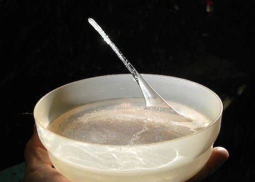

That sounds like an ice-spike.
I have a few feral cats around my house that I try to keep fed and watered. It's a bit difficult in the winter to keep their water from freezing though. One day this January, I found this on my front porch:
I got all excited and took pictures, thinking I'd created the worlds largest ice spike.
I googled it, and found there have been much bigger ones.
Still weird though.

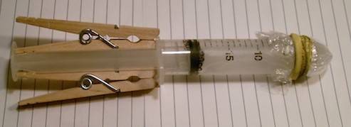

My syringe vacuum ice cylinder maker setup:
I would explain, but I'm late for work.
Hint: There's only 15 cc of water in there.
