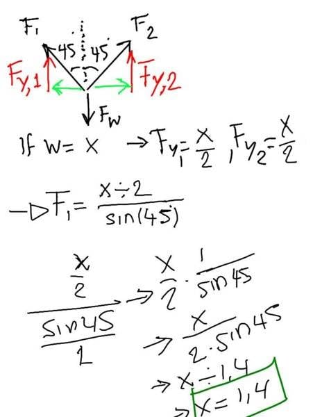

It initially feels kinda complex, as not much info is provided; no force and not even the weight of the object is given, only that the force that needs to be applied is 1.5 times greater in situation b. I need to proof why is it 1.5x greater. The approach that seems most wise to me is choosing a random value for the weight, and applying the trigs in the sources from that point on. Do you think my approach sounds proper?
Thanks a lot in advance

Here is the weight: ##x##. You don't have to pick a numerical value, the weight will cancel in the ratio later.
It's actually closer to 1.4, so don't get hung up on the 1.5 approximation.
Thanks a lot everybody, for the support.
I indeed eventually arrived at 1,4, good to know, that takes away some doubt :)! The X that I found calculating it the way I did it, is a ratio number and not the weight. Am I doing it mathematically/systematically correct? Or is it maybe better to say delta W = x or formulate it slightly differently?
