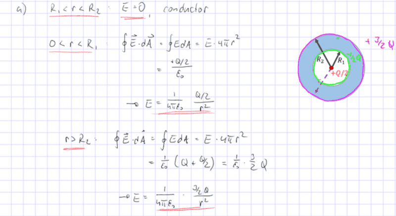

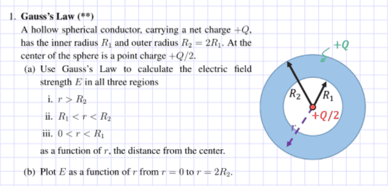

Hi there, I have following problem at hand:
(any help would be appreaciated, I have a test tomorrow)
1. Homework Statement
Above is obviously the teachers answer to the problem, what I don't get though; is, where does the 3/2 come from, at r > R2? And how did he get to the conclusion that the electric force is exactly 3/2 away?
Thanks in advance!
- on a sidenote, why does almost every ElectroDynamics question not involve any real cases/numbers /frustration out
What's the total charge contained within a gaussian sphere at that radius?
The problem just states that the center of gaussian sphere has charge enclosed, Q/2.. no real values are given.
Give your answer in terms of Q. What's the total charge contained within a gaussian sphere with radius > R2?
Well that exactly what I can't seem to figure out. I must have overseen some rule regarding Gaussian Surfaces- since appearantly the charge triples outside the surface? from Q/2 to 2Q/3.
The Q/2 is the enclosed charge..
I think you mean that the charge on the outer surface of the conductor is 3/2 Q. That happens to be true, but that is not needed to answer the question.
That is incorrect. What's the total charge inside the Gaussian surface? Just add 'em up.

If the Gaussian surface is the purple ring, and we add up Q/2 - Q/2.
It still confuses me that outer surface of the conductor reaches 3/2 Q
When r > R2, you have three regions to worry about: r < R1, R1 ≤ r ≤ R2, and r > R2. Try rereading the problem statement and answer the following questions:
  1. What's the total charge inside the hollow part of the conductor? This is the charge in region iii.
  2. What's the total charge on the conductor? This is the charge in region ii. (Note that you don't care about the distribution of charge here.)
  3. What's the total charge outside the conductor? This is the charge in region i.
Then, as Doc Al said, just add them up. That's the total charge inside the Gaussian surface.

IvanSaurus said:
Now I am totally lost :) a guess would be "0"..
No. Remember I'm talking about a Gaussian surface at some point r > R2. (This is called region i in the problem statement.) So everything is included within it.
If by the "purple ring" you mean a surface with radius R1 ≤ r ≤ R2, then you would be correct. Since that surface would be within the conducting material, the net charge within it must be zero.
Well, what's the total charge on all surfaces?
