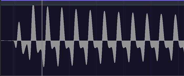

Sorry if this is the wrong place for this question. I am a musician and recording engineer trying to learn about why my bass guitar recordings sometime appear with the waveform going up first (positive polarity) and other times going down first (negative polarity) in my DAW (digital audio workstation). It seems to be related to how the sound is created with the instrument. For example: If I gently hit the strings down with the palm of my hand, the waveform appears positive to start with a positive polarity while if I play with my fingers normally plucking the notes, the polarity seems negative at first. Can someone explain why?
Also, can someone please explain why changing the polarity sounds different coming out of my studio monitors. Shouldn't flipping the polarity sound the same since all you are doing is flipping the sound wave upside down?
Just trying to understand your description: when you strike the strings in opposite directions, the waveform polarity also switches from positive to negative?

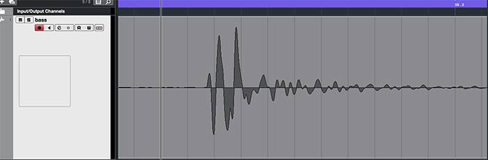

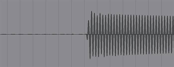

Thanks for the reply. When playing the bass normally with my fingers the "leading edge" of the waveform is negative but before playing I actually did a test and hit down on the strings with the palm of my hand. The reason why I did this is because I wanted to see what the polarity was in my DAW and to test it with a normal bass note is harder because there is less of a transient. The more percussive sound you get when hitting the strings downward is easier to see the transient and if the waveform starts with a negative or positive cycle. I got the idea on how to check this from this website (https://www.johnvestman.com/polarity.html) which talks about the importance of having a positive polarity in your music recordings.
Does it maybe have to do with which way the strings are moving? When I pluck with my fingers I pluck the string upwards and inwards but when I hit the strings they tend to go down more towards the pickup... not sure here, so just guessing
I know that humbucker magnetic pickups are wound with multiple coils that alternate polarity (so any overall magnetic field interference will cancel) and I believe that bass guitars may alternate the polarity of that arrangement across the four strings. Do adjacent strings behave oppositely?

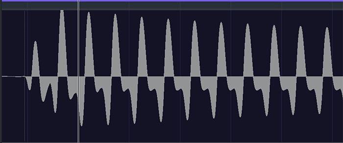

They all seem the same to me. Here are 3 pics. one of the wave when slapping down on the strings you can clearly see positive leading edge but when plucking the strings it seems different. I will add the low E string waveform pic and the high G waveform pic so you can see
This is exactly correct I believe. The magnetic pickups actually produce a signal proportional to the velocity of the string relative to the pole face. Moving towards and moving away will produce opposite voltages in the pickup. Notice this also means that vibrating perpendicular to the guitar face makes a somewhat different response than vibrating parallel. The mixture of those two modes can produce a complex waveform. Check this out:
