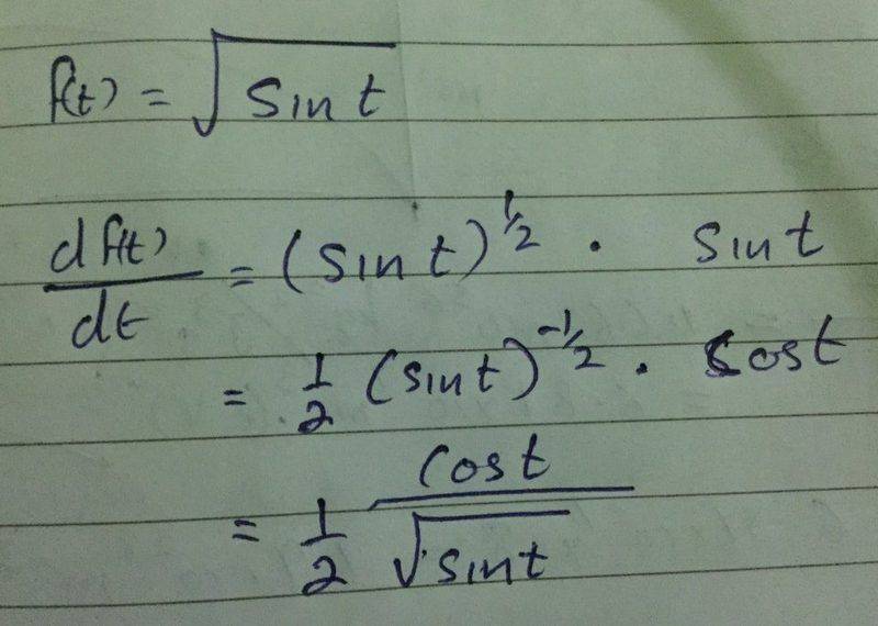

Do you know the chain rule? What is the derivative of ##f(t) = \sqrt{sin(t)} ## with respect to t, for example?

Sorry my bad
Is this ok?
  • #39
lioric said:
Sorry my bad
Is this ok?
No. Somehow you ended up with the correct derivative, but the work you show is wrong.
In the second line of your attached image, you have
$$\frac{df(t)}{dt} = (\sin t)^{1/2} \cdot \sin t$$
This is wrong. On the right side, you haven't taken the derivative yet -- ##(\sin t)^{1/2}## is the same as ##\sqrt{\sin t}##. Also, where did the extra factor of ##\sin(t)## come from?
The third line is correct, and so is the last line.

The end is OK. Now you have the function ##f(t)= {\vec v(t)} ^2##. What is df/dt? Do not worry about that the inner function is a vector, just apply the chain rule.
