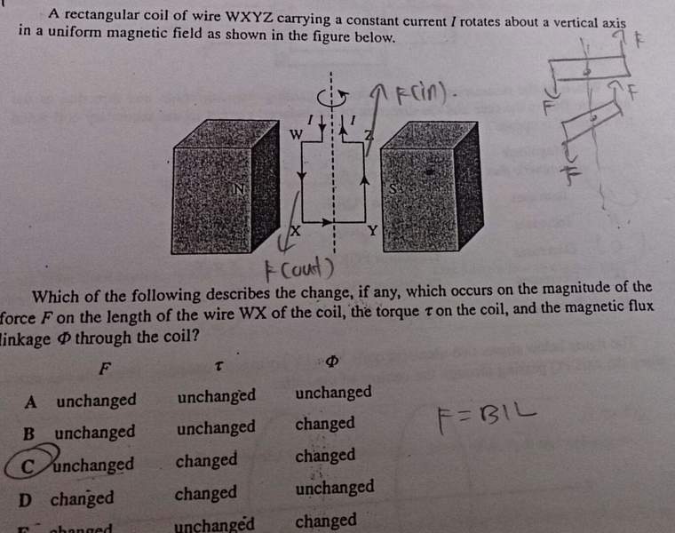

for this question, since area of cutting of magnetic field change, so magnetic flux change, f is unchanged . but i don't understand why the torque will change since the force is unchanged, since torque=FORCE X DISTANCE FROM THE ROTATING PIVOT

Distance between the line of action of the force and the pivot is changing.
Can you explain.further. I can't see and understand the situation.

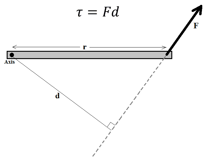

Careful. Torque is generally not equal to the product of the force, F, and the distance, r, between the axis of rotation and the point of application of the force. As dauto is pointing out, torque is the product of force and "lever arm", d.
