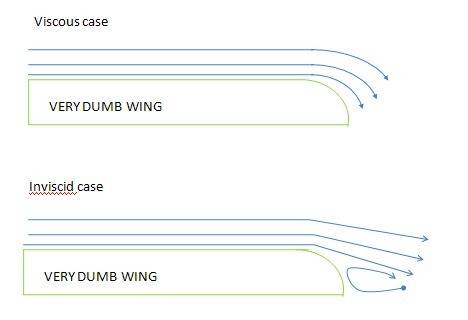

Hello all,
I'm trying to nail down why the viscosity of air helps it bend around a curve. I have a specific, simplified example in mind to cut away other phenomena.
Imagine the region immediately behind the camber of the top of a typical airfoil. That is, the place where the slope of the airfoil first becomes negative. Why do the air streams bend down to follow the surface. I know that it is due to a pressure differential between the streams in the boundary layer, but what causes this pressure differential?
It cannot simply be the wake effect (as the foil moves forward, the region immediately behind the curve is deprived of air since it was where the win "used to be.") Clearly, such an effect occurs regardless of viscosity. The instantaneous absence of air in the wake cannot be the sole reason as evidenced by the turbulence and separation of boundary layer found in the wake of a sphere.
So, I'm trying to understand what it is about the viscosity of air that causes a pressure differential that (in term) allows this bending to occur.
A separate, but related question, I can see how the pressure differential allows for "bending" of air streams around a surface, but the literature I have read suggests this pressure differential is required even after a bend to keep air streams parallel to a surface, or else the layers separate. Why is that necessary? If two air streams are parallel to one another, why is any pressure gradient needed to keep them from separating? I suspect it has something to do with one stream having a different velocity than the other but would appreciate a clear description.

I think I came up with a reasonably simple solution... please let me know what you think.
First, an observation: The change in velocity as you come away from the wing is less and less until, at some point, the air streams are flowing at the "ambient" velocity.
For example, if the ambient velocity is 100 units, you might see adjacent air streams with the following velocities:
Airstream A: 91 units
Airstream B: 91 units
Airstream C: 90 units
Airstream D: 86 units
Airstream E: 77 units
Airstream F: 61 units
Airstream G: 36 units
Airstream H: 0 units
[I'm not claiming the above are accurate, just a depiction of the idea that the difference in velocity is less and less as you move away until it stops changing at the end of the boundary layer.]
Now, what causes this change in the change of velocity? We know that viscosity is caused by diffusion of momentum between airstreams. In other words, particles in one airstream slip into another. If those air streams have the same velocity, this doesn't matter, but when two adjacent air streams have different velocities, the faster one is slowed down and the slower one is sped up, allowing entrainment.
This leads to the observation that particles in stream C are not (in this simplified model) passing into stream B at all. Since stream B is not getting any help from Stream A but is the same velocity as stream A, we must have that stream B is not being slowed down by stream C at all...but stream C is being sightly sped up by stream B, meaning stream B is losing particles to stream C but not accepting any. In other words the pressure in stream B is greater than the pressure in stream C. Similarly, for stream C to maintain a speed so much closer to stream B than stream D, while Stream D is being kept an even greater speed above stream E, we must adduce that there is a net migration from stream C to stream D, meaning a pressure differential there as well.
This continues down the line. At each point more particles come down than go up, tending to push the streams toward the surface. If this pressure gradient is not great enough to maintain this effect, the layers separate, leading to a stall.
Thoughts?

Jeff,
Thanks so much for taking the time to write this, but I'm afraid much of it dances around what I'm really getting at. I tried to limit my question to something very specific: why does viscosity cause streamlines to bend? What causes the the change in pressure?
You state that the change in pressure is due to the angle of attack. While it is true that the angle of attack determines the net pressure differential, it is not responsible for the effect I am speaking of. That was why I picked a very specific point to look at it, the region immediately behind the camber. Streams will tend to deflect downward, trying to follow the contour regardless of the angle of attack. There may be no net lift induced if the angle of attack is poor, but regardless the air will tend to bend around the curve due to viscosity, and I"m trying to understand why it bends as laminar flow in this case but would not bend if air were inviscid.
Thus, the only tool we have is the viscosity of air...and the only understanding I have of viscosity of air is based on "diffusion of momentum" across streams (the tendency of particles in one stream to move to another, so that faster streams can speed up slower ones and vice versa...i.e. entrainment.)
Thus, I'm not assuming the air is necessarily going faster there (though I realize it is) because this tendency for air to follow a contour prevails even if the air nearest the wing is the same speed as the air further away (when it first encounters the slope).
I have put a version of a "very dumb wing" online to help illustrate precisely what I am trying to understand. Why does viscosity account for the difference here, where the understanding of viscosity is "the tendency of one airstream to affect another by diffusion of momentum?"
Thanks!

But that's just the thing! Where are these pressure differentials coming from? As you mention, what is necessary is the deflection of air downward. This entire thread is aimed at understanding why viscosity allows that deflection in the first place. Lift is impossible in an inviscid fluid.
Since this deflection or bending to follow a contour occurs regardless of the things that occur prior to reaching the camber [where streamlines are accelerated due to the fore-part of the camber], I want to see an explanation of this bending that does not require a velocity differential generated before reaching the apex of the camber (hence my "dumb wing" picture.) I know this bending, at its core, is due to viscosity...and I'm trying to understand where the specific pressure differentials that allow this bending come from (which are not the same as the net pressure differential created by the angle of attack, since the air will bend around the top even when there is no net pressure differential...it will just not create net downwash when added to the airstreams coming along the bottom.)

But, again, my question is why? And, in particular, how does viscosity allow a laminar flow to follow the surface of a wing far more than would be found in an invisicid fluid?

As I keep on asking...my question is why does the viscosity of air allow this affect? That has been my question all along: There is clearly a distinct, qualitative difference between the kind of contour-following brought about by viscosity and that simply due to wake (where air can come in from anywhere and the streamlines are just responding to a pressure difference anterior to the surface rather than viscosity effects of the boundary layer.)
For air, viscosity is due to one streamline entraining another, and curvature in the boundary layer is due to a pressure differential between air at the surface and air at the top of boundary layer. This is what I am asking about...not the more general pressure differential between air below the wing and air above the boundary layer. That is why I displayed the ludicrous "dumb wing" drawings to get at this effect without any regard to angle of attack or anything that happens before the camber.
My question has been, and still is, how does viscosity (i.e. diffusion of momentum between streams of differing velocity) allow a far more distinct, laminar Coanda effect compared to what would be expected by the simple wake of a moving wing in the absence of viscosity (which is less pronounced and leads to turbulence where the layers separate).

Most of the website articles I've read only mention viscosity having a signficant effect within the thin boundary layer near the wing where the air transitions from zero relative speed at the surface to high speed just a few mm or cm away from the surface. Once beyond the boundary layer, the rate of change in speed versus distance from the surface of a wing is relatively small, so there's little interaction between those adjacent flows outside of the boundary layer.
The boundary layer is relatively thin. Mose of the contour following occurs outside this boundary layer.
But, Jeff, it is precisely the bending within this layer that I'm interested in...because it is the bending within this layer that is due to viscosity...which is what I keep asking about. I'm not asking "why does air deflect due to a wake" because that is obvious. What I"ve been asking is "how does viscosity allow air to follow a contour far more closely than one be expected in an inviscid fluid?"
Can you please, please, just answer that? (Based on what viscosity in air means: entrainment of streams, velocity distribution in boundary layer, etc.)
And, while the size of this layer is small compared to the entire volume deflected, it is evidently critical to that deflection since low-speed flight would be essentially impossible without viscosity, and viscosity has its manifestation in the boundary layer.
Jeff Reid said:
The static pressure of the air within the boundary layer is essentially the same as the pressure of the air just outside the boundary layer. This is why static ports mounted on the sides of aircraft fuselages can sense the pressure of the ambient air, by "hiding" within the boundary layer, regardless of the relative speed of the ambient pressure air flowing just outside the boundary layer.
I'm not sure what you are saying about my possible explanation of how viscosity allows the boundary layer to hug the surface far better than inviscid air does. Can you please comment on that?
You said that the reason air (in general) cannot perfectly hug a contour is that it has momentum, which makes perfect sense. My hypothesis was that the air in the boundary layer has less forward momentum than other air near the near-future wake/void/depleted zone and hence is better able to claim it for its own, meaning that laminar, contour-hugging flow persists in the boundary layer because (unlike in the inviscid case shown in my picture) air from foreign streams are not rushing into the void to separate layers.
FireBones said:
Yes. And I'm trying to figure out why it occurs in a gas.
In a liquid it is easy to understand due to Van der Waal forces.
In a gas, where the only interaction is diffusion of momentum between adjacent streams, it is harder to see. The wikipedia article does not indicate the cause, even in its section on "cause."
Ok, so the question is equivalent to "can the Coanda effect occur in inviscid fluids?". Amazingly, I can't find *any* quantitative information about the Coanda effect. Tritton's "Physical Fluid Dynamics" has a section on flow attachment, but there's no quantitation.
Perhaps this means that viscosity is an essential component of this effect; are you then asking for the molecular mechanism of viscosity? As an aside, intermolecular forces are not the 'cause' of viscous dissipation; the forces are conservative.
My understanding is that the Coanda Effect is completely due to viscosity because the "Coanda Effect" can be defined as "Why fluids follow their surfaces more than would be expected without viscosity."
I'm not so much looking for a molecular understanding of viscosity itself, but rather the actual relationship between the understanding of viscosity I have and the Coanda effect. I've given two of these in this thread.
My understanding of viscosity in gases is:
1. The particles immediately touching the surface are considered to have zero velocity relative to the surface
2. particles can (quite understandably) slip from one air stream to another (or, similarly, particles in one air stream influence another), and this means that if one air stream is adjacent to another with a different speed, then each will mitigate the other's speed: the faster one will tend to speed up the slower one and vice versa.
[Note, I don't mean that velocities change along a streamline due to this interaction...what I mean is that the velocity in one stream line is "different from what we would expect without any interactions." I hope that is clear enough...]
I can understand how this sets up the velocity profile in a boundary layer.
Now, what I"m trying to do is get from that understanding of viscosity to an understanding of why streamlines of a gas in the boundary layer can hug a contour much better than they would were there no viscosity.
In the liquid case, Van der Waal forces would make this a piece of cake...
Wikipedia claims that Frank White's 5th edition of Fluid Mechanics (2002, McGraw Hill) describes why viscosity allows the Coanda effect. They source this text for the second half of the quote below.
Wikipedia said:
In the aerodynamics field, the Coandă effect is commonly defined in the more limited sense above, and viscosity is used to explain why the boundary layer attaches to the surface of a wing.
FireBones said:
How does viscosity allow air to follow a contour far more closely than one be expected in an inviscid fluid?
I don't know that it does except at very low speeds were viscous effects are dominant over inertia effects. As mentioned in the wiki boundary layer link, within the boundary layer viscous forces are dominant, and outside the boundary layer, inertia forces are dominant, but I don't know how much viscosity contributes to bending of the boundary layer, as Andy mentioned, I haven't seen any quantitative information stating that x% of the bending of the airflow within the boundary layer is due to viscosity, versus void effect and pressure differential drawing the boundary layer (and the adjacent air) around the cambered surface of an airfoil.
A re-think on this.
Imagine a wing with a cambered surface initially at rest within an inviscid gas or fluid, that then starts to accelerate. During the acceleration of the solid object, 'void effect' would be a factor. The surrounding gas or fluid, would be accelerating to fill in what would otherwise be a void left by the wing. The issue is if the fluid accelerates downwards or forwards in order to fill in that void. If the cambered surface is gentle enough, then the gas or fluid accelerates primarily downwards since that is the way in which the void is being introduced into the gas or fluid. In this case, even when the wing stops accelerating and moves at constant velocity, you end up with the 'wake' effect you mentioned before, and as the wing flows through the fluid, a downwards and somewhat forwards and somewhat rotating moving wake moves along with the wing.
What viscosity adds to the boundary layer is a shearing torque, you have a forwards skin friction force, and a backwards viscosity related forces until you get far enough way that the speed gradient versus distance from wing surface diminishes to some small amount. It would seem that if the flow remains laminar, than the shearing torque would "bend" the flow. If the flow becomes turbulent, then the shearing torque produces vortices in addition to "bending" the flow. It turns out that depending on the speed, it's easier for somewhat turbulent flow to remain attached (or to reattach) than laminar flow, so in some cases, the turbulent flow "bends" better than the laminar flow.
http://en.wikipedia.org/wiki/Boundary_layer
Jeff Reid said:
A re-think on this.
I came to similar conclusions this morning when I decided to go back to the basic governing equation for flow lines: The Navier-Stokes equation. And when I did that, the answer became evident.
The solution combines the two ideas I gave earlier:
https://www.physicsforums.com/showpost.php?p=2496546&postcount=3
https://www.physicsforums.com/showpost.php?p=2496546&postcount=10
And my "combination" here I don't mean "a little bit of both."
Rather, if you look at the plight of a stream-line that has just had "the bottom fall out from under it" (that is, the surface is curving away), you can speak of its momentum carrying it forward and pressure pushing it down.
I earlier mentioned that the fact that these particles are going more slowly should help them "turn the corner" but when I looked at the Navier-Stokes equations I realized they also are helped by the velocity gradient I discussed in my first option (post number 3 in this thread).
If you look at the velocity profile in the boundary layer, you see that its second derivative (wrt the distance from the wing) is decidedly negative. (This was what I was getting at in post 3), but the Navier-Stokes equation (for incompressible liquid) indicates that this is exactly what accomplishes the viscous side of acceleration in a viscous liquid:
density * Acceleration = (negative of pressure gradient) + viscosity * (vector laplacian of Velocity).
In the case of the velocity profile near a wing, this "vector laplacian of velocity" goes against the flow in the airstream.
Thus, when bending the corner there is a "downward" force due to the void effect and a "backward" force due to viscosity (the "shear stress" you mention.)Upon thinking a bit more I realized what the Navier-Stokes equation is really saying: because the boundary layer is concave up, a given stream is being slowed (by the streams below it) more than it is being sped up (by the streams above it). Thus, there is a slight negative acceleration along a streamline. This is why the boundary layer widens as you go along the back of a an airfoil.
This negative acceleration is, of course, exactly what is needed to help a streamline catch the curve and crowd out other streamlines that are vying for the void.
shearing torque
The effect of this is limited by the flow just outside the boundary layer, which is dominated by 'void effect'. If that external flow doesn't bend as much, it ends up causing the boundary layer to become thicker and with more turbulence, reducing it's bend, perhaps detaching, so it would seem that there is a competing balance between shear torque and void effect, depending on airfoil, AOA, speed, ...
