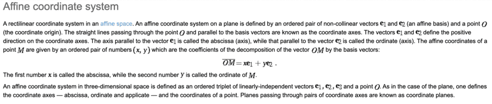

As far as I know, a set of vectors forms a basis so long as a linear combination of them can span the entire space. In ##\mathbb{R}^{2}##, for instance, it's common to use an orthogonal basis of the ##\hat{x}## and ##\hat{y}## unit vectors. However, suppose I were to set up a basis (again in ##\mathbb{R}^{2}##) with two vectors which weren't orthogonal, ##\hat{a}## and ##\hat{b}##. The vectors can still span the space, so everything seems fine. However, if I try to express a vector law in terms of this basis, like
$$\vec{F} = m\vec{a} \implies F_{a}\hat{a} + F_{b}\hat{b} = ma_{a}\hat{a} + ma_{b}\hat{b}$$
then a few problems arise. If we compare the coefficients of any given component, the result is valid (i.e. ##F_{a} = ma_{a}##). However the overall expression is just wrong.
For one, the magnitude of ##\vec{a}## is not ##\sqrt{a_{a}^2 + a_{b}^{2}}##; we know this because to compute the real magnitude we'd need to use the cosine rule. However, I thought that a property of vectors was that the magnitude is the root of the sum of the squares of the components (although I'm assuming this only applies if the basis is orthogonal...).
So then I'm conflicted, since it seems valid to use a basis with basis vectors that are not orthogonal, but now the usual rules of vectors don't apply (or at least they need to be tweaked slightly). So is that to say we can only use an orthogonal basis? Thank you!
Some of these "usual rules" that you're thinking about (such as the one about the magnitde being the square root of the sum of the squares of the components) are orthonormal-only special cases of more general rules. If you are not using an orthonormal (othogonal isn't good enough) basis you need to use the more powerful and general rules, not the special case ones.
You might want to spend some time reading up on the "metric tensor" and practicing using it with various weird coordinate systems in the Euclidean plane.

Mathematically you must be careful about some things here.
First, in a vector space there is no concept of orthogonality until you have defined an inner product. Nor of the length of a vector.
Once you introduce an inner product, you can define what it means for two vectors to be orthogonal and for a vector to have a certain length, including the special case of having unit length.
The usual inner product is defined in such a way that the vectors ##\hat x, \hat y, \hat z## form an orthonormal basis.
If you have the components of a vector in a different basis, then the inner product can be computed using the appropriate basis transformation matrix. Then you are into the heart of linear algebra with the notion of unitary transformations that trabsform one orthonormal basis to another etc.
