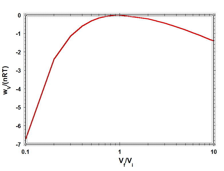

Actually I tend to agree with Chestermiller but still wonder whether the reversibility will affect dU in the way Thermo has mentioned. Let's imagine the adiabatic expansion is not free but the pressure decrease very slowly and the gas actually do some work, the dU certainly is not zero.
So I think what the guy in the video was trying to do is to compare the dU in reversible and irreversible processes, but he got the wrong conclusion. Because the final state that the system achieve by a reversible path is different from that by a irreversible path. One cannot say because dU is not zero in a reversible path then it is also not zero if the gas expand freely. First law of thermodynamics must be obey so if dQ and dW are zero then dU must be zero.
I totally agree.
Here is a link to my recent article in Physics Forums Insight that may be of interest to you:
https://www.physicsforums.com/insights/understanding-entropy-2nd-law-thermodynamics/
Chet
