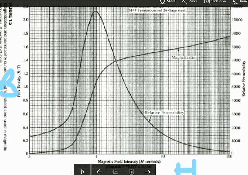

Utilizing the magnetization curve is also confusing for me..see picture

You can get the value of relative permeability of the core for B=1.2T from the magnetization graph.
Once you have the relative permeability of the core, all you need to do is simplify the magnetic circuit.
I think then, if I go across from 1.2T, the Relative Perm = 6000 ?
Yes.

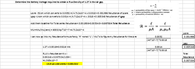

Ok..So that means MUr=Mu/Mu(zero) = 6000/4pi*10^-7 =4.712x10^-4 which = Mu
*A
I can now go into my Reluctance formula Fancy "R" =small "L" / Mu*A to figure my Reluctance for the core
then-
Lcore - 52cm which converts to 0.0052 m/4.712x10^-4 x 0.0018 = 0.001986 Reluctance of Lcore
Lgap -14cm which converts to 0.0014 m/4.712x10^-4 x .0018 = 0.005348 Reluctance of Lgap
Add them together for Total series Reluctance = 0.001986+0.005348 = 0.007334 Total Reluctance
flux x reluctance= number of turns x current
flux x reluctance/number of turns =current
Then I know the current
once I know the current, I can multiply against the 64 ohms resistance to tell me the voltage across the gap?
In my head this seems way too easy!
JOE

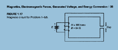

OK=nexy questions, now my brain wheels are turning...
Since this magnetic circuit is a series circuit, is the gap creating a Positive top part of the core, and a negative bottom part of the core! This would explain why the voltage drop is across the gap.. Am I right?
JOE
JoeMarsh2017 said:
once I know the current, I can multiply against the 64 ohms resistance to tell me the voltage across the gap? **voltage of the battery** There's no voltage across the gap.
JOE
Right.
Since this magnetic circuit is a series circuit, is the gap creating a Positive top part of the core, and a negative bottom part of the core! This would explain why the voltage **mmf** drop is across the gap.. Am I right?
JOE
Right. You can see that the mmf drop Φxs is very high across the air gap.

I didn't check your earlier calculations but your steps are all correct. Check the reluctance values again. I think air gap reluctance should be very high.

JoeMarsh2017 said:
That doesn't look right. Voltage and current are too small.
*A
No. You should use the absolute permittivity μ, which is μ0μr.
This was making your reluctances very small.
JoeMarsh2017 said:
We also have View attachment 111613
First thing is to realize that the permeabilty of space is << any permeability in your iron or whatever your core comprises. So compute the reluctance of the air gap, then flux x reluctance = mmf = Hi.
