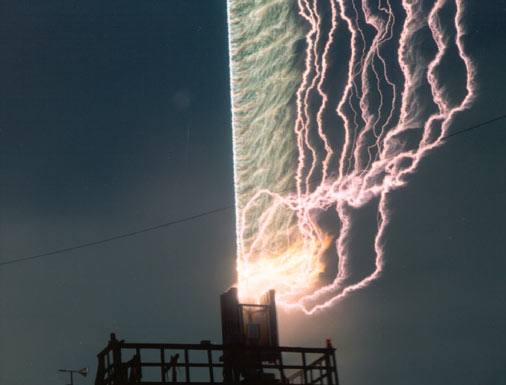

I don't think it ads clarity to the answer, but rocket triggered lightning experiments make it graphic. Below is a still picture and a video. The still picture shows that what appears to be a single strike is actually multiple strikes all occurring in a fraction of a second. Wind moves the ionized air molecules between the strikes. The video shows what they called an anomaly in the path.
The video shows that the lightning starts with the rocket's wire, but by the end, it finds its own path. This seems strange to me. Clearly there are better electrical paths than a nice, straight line of copper ions (which seems counter-intuitive). It makes me wonder it the spectral content causes the fractal pattern rather than the other way around? But what would be the mechanism?
The wire is vaporized on the first stroke. Then the wind moves the ions horizontally. Later strokes follow the displaced ionized path. I don't think you can think of it as a single event.
Even if the wire doesn't vaporize, it could ionize the air near the wire surface. Then wind moves the air while the rolling boat moves the wire before the next stroke.
Also, there is often a lot of vertical wind shear near the ground.
Complexities everywhere you look. Your question is very difficult to answer.
