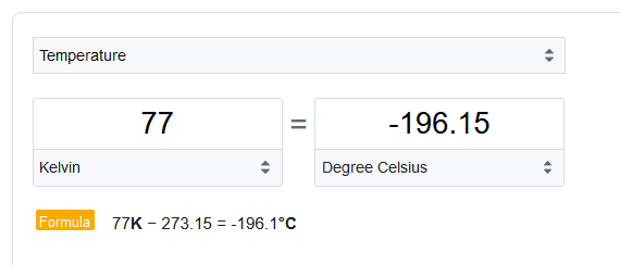

It looks like the ad says 77K, which is more like -195C:
https://www.google.com/search?client=firefox-b-1-e&q=convert+77k+to+celsius
But if you have access to liquid nitrogen, it seems like that should be cold enough. Can you check the resistance instead?
