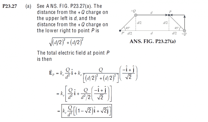

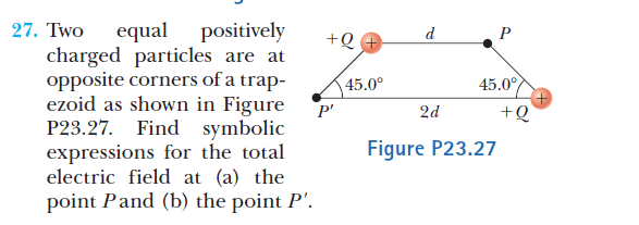

E = [kq/r^2]r -------> r is the unit vector
I did the same thing as the solution below, however, I do not understand why there is root-2 in the denominator. I would appreciate it if someone could explain this to me.

How would you express the unit vector going from each Q to point P?
it would be E=[kQ/d^2]i
That's for one of the Q's. What about for the other one?
Note that it's essential to make sure you have set up a clear coordinate system for the problem.
It would be E=[kQ/2d^2](-cos45i+sin45j)
