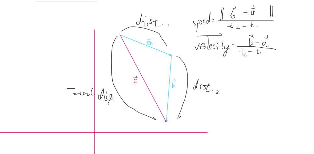

Leo Liu said:
Speed is just the magnitude of the velocity vector. In this case the displacement is less than the displacement because some components of the velocity vectors throughout the motion could cancel out one another.
Bonus: In a circular motion, the displacement is essentially 0, as the distance traveled is not 0. In this case both the velocity and the speed is not 0 or ##\left\langle 0, 0 \right\rangle##bcause the velocity changes direction and the speed is constant.
I'm sorry I can't see what you mean.
In your second line, " cancel out one another"; What are the components that are canceled out?
In your last line, "speed is constant"; Why does the speed constant in gravity?
Sorry if that wan't clear. Every infinitesimal displacement vector can be added together, but they have directions which make the total displacement less than or equal to the distance.
If you want some intuition, you can imagine a triangle with three sides a, b, c, in which side a and b are infinitesimal displacement (##\lim_{x,y\to 0} b(x,y)## ##\lim_{x,y\to 0} a(x,y)##, where x and y are the components of the vectors). The side c is a resultant vector of a and b, denoting the total displacement. So we can write ##\lim_{x,y\to 0} c(x,y) = \lim_{x,y\to 0} b(x,y) + \lim_{x,y\to 0} a(x,y)## (again, vectors can be added together). In comparison, the tiny distance traveled is sum of the length of a and the length of b. An axiom of geometry tells us that the length of two sides in a triangle added together must be greater than the length of the other side; therefore, the length of the displacement vector c must be smaller than the distance which is the length of a and the length of b added together.
Now back to your question--why does the length of the velocity vector equal value the speed? It is because both of them are instantaneous (not average) in this case. So it is not legitimate to divide (not rigorously saying) c by a unit of time to get the instantaneous rate of change, otherwise you are calculating the average velocity in this tiny time interval. If we think a bit further, the speed at a point is equal to the tangent of the distance function (the change in the length of vector, which is b-a if we assume the object travels from a to b), which is also equal to the length of the velocity vector. The displacement vectors merely give the velocity vector a direction.
I hope this helps.

Leo Liu said:
therefore, the length of the displacement vector c must be greater than the distance which is the length of a and the length of b added together.
You must mean smaller there not greater. You are right that the triangular inequality is behind all this. The proof of inequality in my post #16 is based on triangular inequality of the modulus (norm) of a vector $$ \|\mathbf{v_1}+\mathbf{v_2}\|\leq\|\mathbf{v_1}\|+\|\mathbf{v_2}\|$$

ggandy said:
Thank you for your kind explanation, but I'm sorry I can't still understand your added explanation. Maybe the reason why I can't understand is it just consists of texts without images. I'm going to try again to understand that, thank you.
Handwritten diagram of a curved path with two blue vectors a and b joined head to tail, a red resultant vector c from start to end, and dist.1 and dist.2 arcs along the path; beside it, speed = |b - a| / (t2 - t1) and velocity = (b - a) / (t2 - t1).
If you zoom in on the trajectory of the object, it will become many some line segments. The diagram is simply a representation of a piece of the trajectory. Since the motion has direction, we just consider them as vectors.
