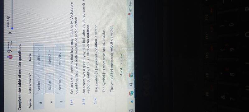

Is the v in the suvat equations a scalar or a vector?
I thought velocity was always a vector quantity, one with both magnitude and direction.
When it came to the suvat equations, where v = final velocity, and u = initial velocity, I thought both of those were vector quantities, e.g;
v (final velocity) 112km/hr North
u (initial velocity) 0km/hr (I'm now asking; what do we put for direction when the object is initially stationary?)
But in a Khan Academy question they ask what does the letter v (lower case with no arrow above it, or anything else) stand for, and whether it’s a vector or a scalar.
I answered ‘velocity’ (it was multiple choice with no option for ‘final velocity’) and that it was a vector.
Their answer was;
“The symbol v represents speed, a scalar.”
I know speed is a scalar, but thought v stood for final velocity.

Thanks, PeroK.
Here's what they said.
In that case, my assumption of 1d motion was in error and I agree with them. ##\vec v## is the vector and ##v=|\vec v|## is a scalar.

Thanks. Really helpful answer.
Regards the letter with the arrow above it ('arrowed letter'); does that arrow always point to the right? Is it just there to tell you it's a vector quantity, rather than having anything to do with right being positive, left being negative, etc?
Also, I'm wondering now if, given the context, they are correct in saying that their 'v' means speed, a scalar, the context being; an arrowed x, for position, an arrowed v, for velocity, and an arrowless v, for speed.

Here's what they said.View attachment 355012
As long at they are consistent in their course material then that is fine. Also, that may be in a section on 2D and 3D motion. In the section on 1D motion, they may say that in this case it's common to drop the vector symbol and use ##v## for velocity (may be +ve or -ve) and ##|v|## for speed.
Notation in all maths and physics is specific to the context. You can't assume that universally in all cases the same notation applies. Taking statements out of context can be a problem.
Yes - the arrow over the letter only tells you it's a vector quantiity. The arrow always points right by convention. It does not tell you anything about any direction(s).
Yes they are correct. Since there is an 'arrowed v', that is unambiguously a vector. It follows that a 'plain v' is its magnitude (the speed in this case). (As described in Post #6.)
