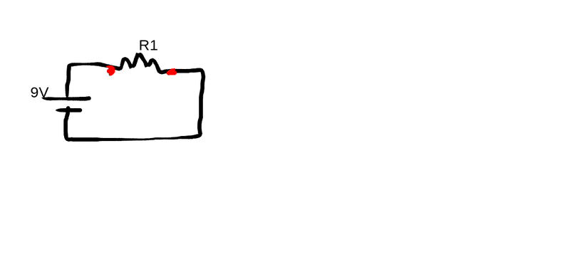

People say that the voltage across one resistor is equal to the voltage supplied.
I've drawn a picture of a simple circuit with two points near the positive terminal. Apparently, if we take the potential difference of these two points, it will equal 9V according to the above saying (which can be found all over google).
But then if the potential difference between the two red dots is 9 V, there will be no force driving the current to the negative terminal of the battery. So this one resistor essentially absorbs all of the energy supplied by our battery. I am confused about this.
Simple circuit schematic: a 9V battery connected in a single loop to a resistor labelled R1, with two red dots marking points on the wire on either side of R1.
We generally assume that the wires in the diagram have no resistance, and thus by ohm's law, have no voltage across them.
Anyway, certainly electrons are moving. Do you have a problem with that? Electrons are moving through the resistor because there's a voltage difference across it.
Now, I don't know if this is simplistic or what, but if there is a flow of electrons across the resistor, then certainly these electrons move through it and in turn push the ones in front of them. But maybe I'm wrong. It seems logical to me.
HI again x86
I touched on this in your other thread with those drawing of the open circuit, resistor and capacitor
Yes the difference is 9V ... so you tell me what the voltages are on each side of the resistor
That is what are those 2 sides of the resistor connected to ??
when you work out the answer to the last part, you will see there is a force driving the current
Yes, now if you give the resistor a value, you can work out how much current is flowing through the resistor
and then how much power is absorbed by the resistor
cheers
Dave
In circuits it is assumed that components are connected by near ideal conductors. These will have vanishingly small resistance so require a voltage of almost zero to conduct reasonable currents, according to Ohm's Law. The practical outcome being that we can consider all of the battery voltage appears across the resistor.
We exaggerate to perfection in order to grasp a concept
then we back up to reality
and judge case by case how far toward perfection it is reasonable to push for each task at hand.
For thinking purposes your simple circuit is actually four resistors and a perfect voltage source in series.
The perfect voltage source is 9.000000etc volts and could deliver infinite current.The four resistors are:
Internal resistance of your 9 volt battery, let's just say 5.00000etc ohms. That's why a 9V carbon-zinc battery only makes a couple amps,
Call that one Rs, for R of source.
R1, your resistor. Let's just say it's 4.00000etc ohms.
Resistance of your two wires, let's call them Rwl and Rwr for resistance of your wires from left and right side of resistor to battery,.
Let's just say they're 0.00100000etc ohm each, about a foot of #10.
What is total resistance of the loop?
The sum of the individual resistances.
Rs + R1 + Rwl + Rwr
5,0000 + 4.000000 + 0.001000000 + 0.00100000 = 9.00200000 ohms.
Now i'll leave it to you to figure the voltage drop across each individual resistance.
What that'll show you is that voltage drop across a wire isn't really zero, it just rounds off to zero.
I grew up before calculators so it's intuitive to me that all calculations are approximate. We always rounded to 3 digits because that is practical limit of slide rule accuracy.I really recommend you work that problem longhand writing every step with all the digits
then again rounding to three digits
that should get your thinking straight.
... drum roll...Using three digit accuracy did your voltage drop across the wires round to zero ?
And if your source really had zero internal resistance like you drew it, would voltage across load round off to same volts as source?

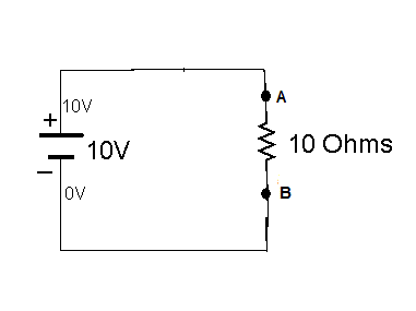

answer me this ...
what is the voltage at point A relative to the battery negative ?
what is the voltage at point B relative to the battery negative ?

davenn said:
answer me this ...
Well, it is known that A-(-) is 10V and that B-(-) is 0V. Although I'm not entirely sure how this can be explained through physics. (Unless we just say that its because experiments told us so). I'm also not entirely sure why A is 10V (but I know it is true, of course).
where is point A connected to ( other than the resistor) ?
It is connected to the +10V terminal.
Yes ! :smile:, so, ignoring that tiny bit of resistance in the wire ( that we spoke about yesterday), the voltage at point A cannot be anything other than 10V
so on the top of the resistor we have 10V and on the bottom it's 0V
so the voltage drops from 10V at the top, to 0V at the bottom :wink:
Ah I see. Is it because of ohms law too? V=IR (for voltage drop). We know that R of the wire = 0, thus the voltage drop is 0. So by ohms law, if it is 10V at the positive terminal, minus 0 V drop, then it has to also be 10V at that point too? It confused me, thinking about potential difference as two points in space, and then implementing that into circuits. But I guess I have to remember circuits are much more complex than just charges in space :)
exactly :biggrin:
and for the same reason, the 0V at the battery terminal is also 0V at point B on the bottom of the resistor
