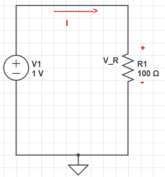

Require clarity on the voltage drop on resistor
Really very elementary one, if i refer the circuit below
For the source in the direction of current the polarity is -Ve to +Ve that is understood which is conventional current, but in the case of resistance in the direction of current the voltage V_R polarity is -Ve to +Ve. Why for resistance the polarity is defined like that?

(1) resistors do not HAVE any innate polarity, they just show a higher voltage where the current flows into them than where it flows out.
(2) current flows from higher voltage to lower voltage, so in this case the current flows as shown ("I").

The direction of the voltage drop should be pretty clear from context, but there does exist quite a straightforward sign convention to stop you from mucking up. With any circuit element on the schematic, you have a reference direction for current and a reference direction for voltage.
If the reference directions for the current and voltage are in opposite directions, then the defining equations for passive circuit elements don't have negative signs, i.e. ##v=iR##, ##i =C\frac{dV}{dt}##, ##V = L\frac{di}{dt}##. That's called the passive convention.
And if the reference directions for current and voltage are in the same direction, then the defining equations for passive circuit elements do have negative signs, i.e. ##v=-ir##, ##i=-C\frac{dV}{dt}##, ##V=-L\frac{di}{dt}##. That's called the active convention.
[N.B. that with the passive convention, passive elements have positive power whilst active elements (like batteries) have negative power. And vice versa for the active convention.]

The voltages around the loop have to add up to zero (Kirchoff's Law).
