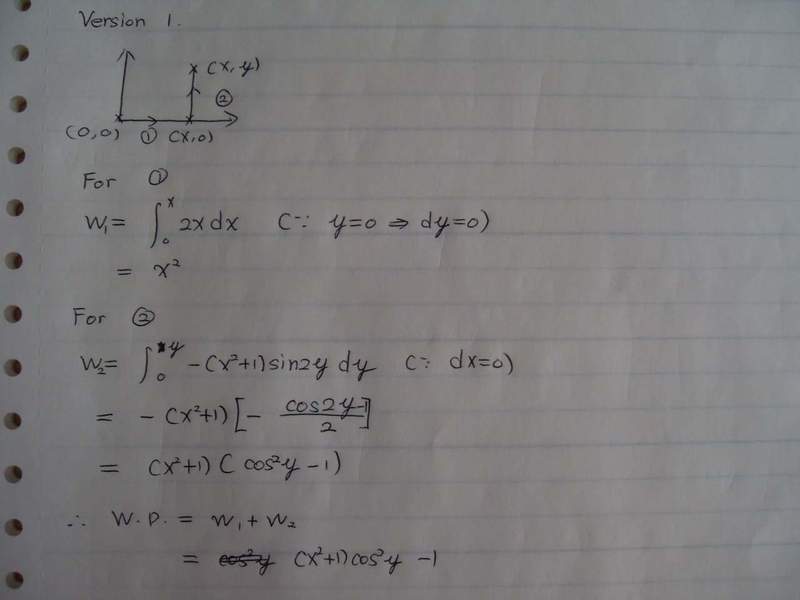

athrun200
275
The answer should be [itex]-(x^{2}-1)cos^{2}\theta[/itex]
But I get a constant -1.
Why?

lanedance said:
can you explain what you are attempting to do? I would approach as follows
Sorry that I skip some steps and forget to give explanation.
This is my approach.

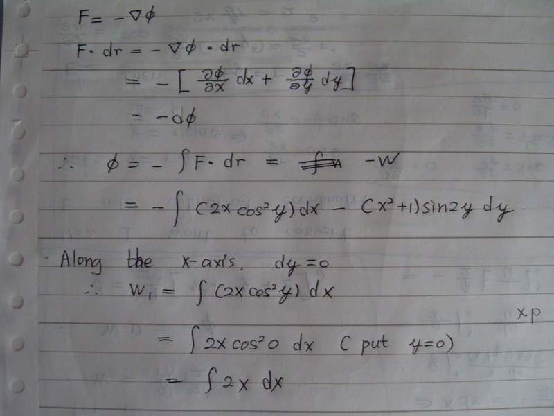

lanedance said:
say phi exists then you know
[tex]F_x = \frac{\partial\phi}{\partial x}[/tex]
[tex]F_y = \frac{\partial\phi}{\partial y}[/tex]
so integrating the first gives
[tex]\phi = \int F_x dx= \int 2x cos^2y dx =?[/tex]
This yields [tex]x^2 cos^2y+C[/tex]
But how to find the constant?

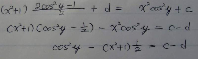

[itex](x^2+1)\frac{cos2y}{2}+C(x)[/itex]
it can then simplfied as
[itex](x^2+1)\frac{2cos^2y-1}{2}+C(x)[/itex]
i can't quite follow your simplification, you should equate
[tex]\phi = \int F_x dx = \int F_y dy[/tex]
also I would use a different constant function for the 2nd integral (say c(y) for first and d(x) for the second)
and from there you should be able to deduce withther it is possible to to solve c(x) & d(y)

I would like to ask, what's wrong with my method above?
I have solved a lot of problems by using that method.(I learn it from mathematical methods in the physical sciences Chapter 6 sec8)

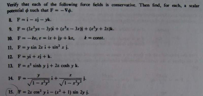

athrun200 said:
It's my first time to solve the problem like this.
So I stuck in here
stick to whatever you're comfortable with... took me awhile to figure out what you're doing as there's a few jumps (also the big pics are difficult to read on a laptop screen), but i think you set phi=0 at the origin and do a path interval over F to find the form of phi if it exists, in essence i think they're the same thing though yours has the advantage of setting one value to zero in the integral
also note the potential is only unique upto a scalar additive constant ie (phi) or (phi +1) give the same force field
