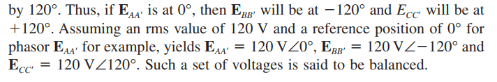

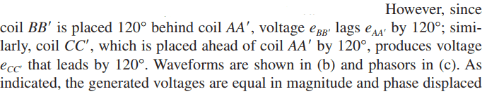

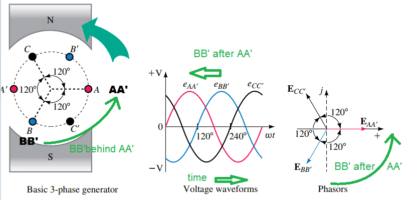

The phase sequence mentioned in the book is confusing
I saw the information of the text at different places and when i compare it is confusing.
Diagram of a basic three-phase generator with a rotating magnet between N and S poles, coils A, B, C and A', B', C' spaced 120 degrees apart; beside it, voltage waveforms eAA', eBB', eCC' against wt, and a phasor diagram with EAA', EBB' and ECC' at 120 degree spacing.

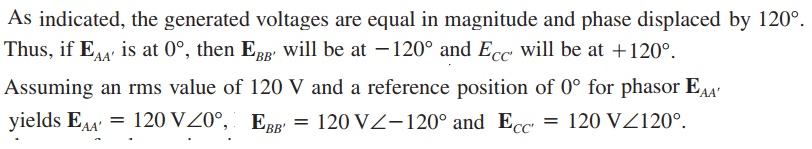

The text is
Textbook page excerpt on balanced three-phase voltages: coil BB' lags AA' by 120 degrees, coil CC' leads by 120 degrees, with phasor equations EAA' = 120 V∠0°, EBB' = 120 V∠−120°, ECC' = 120 V∠120°. The lines are underlined in red.

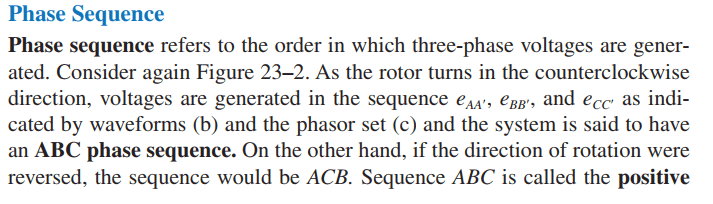

In some other section
Textbook excerpt under the heading Phase Sequence, explaining that the ABC phase sequence occurs when the rotor turns counterclockwise and that reversing rotation gives ACB, with eAA', eBB', and eCC' underlined.
If you see the red lines i have highlighted, in the first section the book refers that the B coil is behind the A coil, but in the 2nd section it refers that in the counter clockwise the voltage is induced in B first than in C. Please help me with this.
The other question is the phasor of the B can it be represented as
Handwritten or printed phasor expression: E_BB' = 120 V angle 240 degrees, with the subscript BB' and the polar notation shown.
Which is the standard?

I'm not understanding the contradiction here, or perhaps what it is that's confusing you. If you consider that the winding voltage (noted by it's positive peak, for example) is represented by the Real part of the phase vectors (the projection onto the x-axis) and that those vectors are rotating CCW, as specified then then the phase sequence (in time) is ABCABCAB... So the voltage peak of B lags A; it's behind A in time. Likewise B leads C; it's ahead of C in the time sequence.
There is often some ambiguity in identifying this stuff because of the rotation symmetry (like modulus arithmetic), so much of this sort of communication depends on people's definitions. The overriding point is that there are two possible sequences which need to be named somehow; ABC vs. ACB, which is the same as BCA vs. CBA, etc. I think your confusion is likely more about how things are defined than any real misunderstanding.
Having work for many years with 3-phase stuff, I can assure you that you will continue to be confused by other people's seemingly arbitrary choices. Yes, there are some industry standards, but they are often not followed because in practice you will often just try one way see if that's the order you wanted. For example, you connect your motor with a random order and try it, if it spins backwards, then you switch two of the phases and it will be correct. In cases where you can't afford to guess wrong, then you will have go through all of the documentation and do some other test to verify it will be correct before you turn it on.
In our installation manuals for a product with a water pump, we specify the correct phase order referenced to the wire colors on our power cable with language similar to that in your textbook, specifying the order of the voltage sequence to be applied. I've never heard anyone talk about positive or negative phase sequences, that definition is a little too abstract to rely on in practice. Rather, we describe how it must behave, not what name it has.
edit: 240o vs. -120o isn't really an issue for people that understand phasors, we all know what you mean. In practice I mostly see people using the (-180o, +180o] range.
The important thing here is to fully understand the concepts, so you can adjust to other people's definitions. For example in mechatronics, motors with other phases, like 90o or 72o are common.

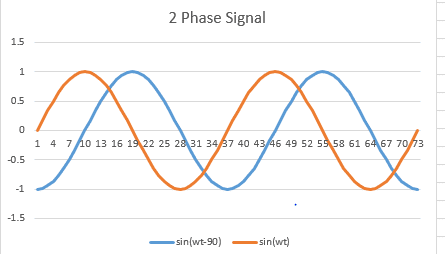

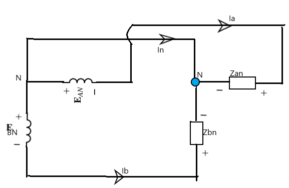

I was curious how it looks like and came up below diagram.
Circuit schematic of a two-phase system with a common neutral node N, showing source EAN and EBN, currents Ia, Ib and In, and load impedances Zan and Zbn.
The voltages induced in the two wingdings are as shown below. ##\sin(\omega t - 90)## in the B phase, ##\sin(\omega t)## in the A phase winding.
Line graph titled 2 Phase Signal showing two sinusoidal waves, sin(wt-90) in blue and sin(wt) in orange, with the orange wave leading the blue by a quarter cycle; y-axis from -1.5 to 1.5, x-axis from 1 to 73.
The current through the neutral is
##I_N = I_a + I_b ##
## I_N = I\angle0+ I\angle{-90} ##
## I_N = I\angle{-45} ##
So, the neutral current is not zero. Hence it is kind of wasted. Am I correct?

I'm not about to defend 2-phase 90o distribution systems, but I do know they have been built. I suspect it's to save money in the number of wires in the distribution network, at the expense of more stuff (transformers, for example) at the load centers. This is a minimal way to generate multi-phase voltages, you must have two voltage sources with a phase difference ≠ 0, or 180o to make a rotating magnetic field for motors, etc.
How you make 3-phase delta from two 90o shifted sources is essentially just trigonometry. You use transformer windings (or perhaps autotransformers) to scale and add the two phasors at 0, 90o to create a couple more at ±120o. So -(1/2)sin(ωt) + (√3/2)sin(ωt + π/2) = sin(ωt + 2π/3). for example. Most often the neutral isn't used; if you need wye distribution then a delta-wye transformer is usually employed.
I don't recall ever hearing of people using the two 90o shifted phases together without reconstructing 3-phase, but I'm sure it has been done somewhere. At this level it's all about cost, and there are lots of other considerations too. However, none of this is common in my experience.
