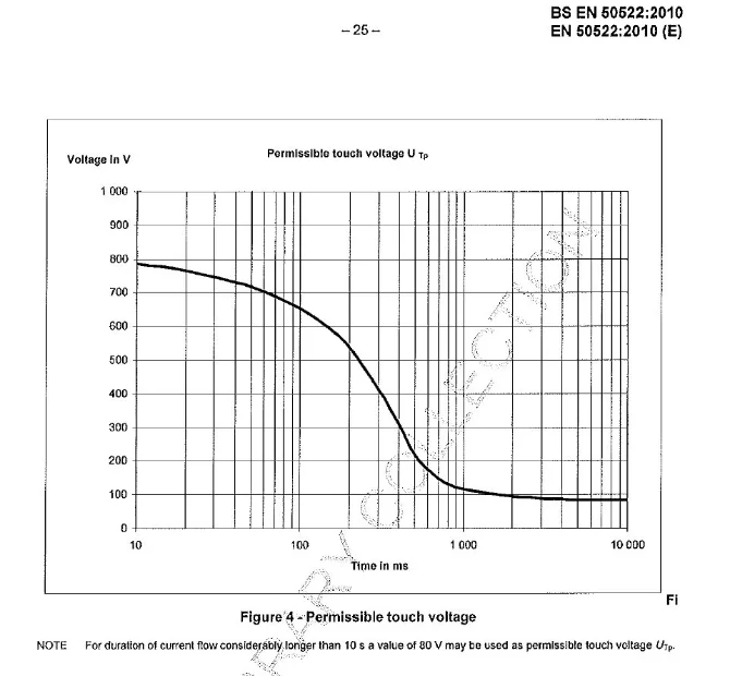

I agree with the statement: the ground [earth] will be the same potential as the normally non-current carrying conductive materials enclosing electrical conductors or equipment, or forming part of such equipment. However, it is not exactly.
N.E.C. Art.250 considers as the maximum voltage [on low-voltage installation] to ground, on the ungrounded conductors, does not exceed 150 V.
The fault clearing time is very important also. Shorter time permits a higher voltage.
On grounded systems the fault to ground current is higher. Then the clearing time is shorter if the current is higher so the protection may act quickly.
For high-voltage systems the grounding electrode is a grounding grid where the short-circuit to ground produces touch and step voltage drop of a limited level with respect the fault clearing time. Even if the system is not grounded the phase-to-phase short-circuit occurs and the and the current rises in the same way.
From the international [ and British ] standard for grounding in power installation exceeding 1 kV:
