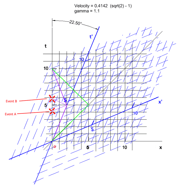

See the space-time diagram below.
The Twin Paradox
One twin stays on earth.
One twin leaves Earth at high speed (0.4142c), travels for 5 Earth years, and then returns.
The stay-at-home twin says that 10 years have elapsed since the traveller left.
The traveller says only 9 years have elapsed since she left.
Two things need to be explained:
Paradox 1. Why is the traveller only 9 years older whereas the stay-at-home twin is 10 years older?
Paradox 2. All the time that the traveller is travelling, the traveller observes stay-at-home's clock to be running slower than traveller's clock. And, all the time that traveller is travelling, stay-at-home observes traveller's clock to run slower than stay-at-home's clock. So each observes the other's clock to be running slower than his own clock so each must be younger than the other!
The resolution is given in the space-time diagram below based on Earth = 10 (years) and traveller (purple line), traveling at 0.4142c relative to earth, taking 9 years, 4.5 years on his blue axes to get to the turn round, and 4.5 years on the blue axis to get back. Note that I should really have drawn a yellow grid angled the other way for the traveller's return journey but the angles are the same so the values read off are the same.
An Event is a point on the diagram. The Earth observer uses the black grid lines to measure the time and space coordinates of the Event in their frame. The traveling observer uses the sloping blue grid lines to measure the time and space coordinates of that same Event in their frame.
Notice that, as he is traveling away, just before he turns round, traveller measures Event A on Earth (earth time t = 4.2) to take place at traveller's time t = 4.5 (dotted purple line of traveller's simultaneity). So traveller measures Earth's clock (4.2) to be running slower than traveller's clock (4.5).
Note that Earth observes the traveller to turn round at Earth time t = 5, but traveller's clock reads only 4.5. So Earth observes traveller's clock to run slower than Earth's clock.
That is, each observes the other's clock to run slower than their own clock.
When traveller is stationary at the turn round, he says time on Earth is now 5 (the dotted purple line would now be horizontal).
When traveller is up to speed going back (but before he has moved any distance) he measures Event B (earth time t = 5.8) to be at traveller's time of 4.5. So traveller jumps (instantaneously) from Earth time = 4.2 to Earth time = 5.8, and "jumps across" 1.6 years at the turn round point.
Similarly, on the way back, it takes traveller 4.5 years.
So, traveller's journey time = 4.5 + 4.5 = 9 years on traveller's clock. But the 10 years of Earth's time is made up of comprises 4.2 Earth years out, plus a gap of 1.6 Earth years, plus 4.2 Earth years back, for a total of 10 Earth years.
Note also that the faster the traveling twin moves the bigger the gap between Event A and Event B becomes. A photon traveling at c (the green line on the diagram) sees no time elapse between departing Earth and arriving back on Earth - the gap between Event A and Event B is now the full ten years.

  • #40
Frodo said:
That is wrong.
Special Relativity deals with things where the observer is not accelerating. ie the observer is in an inertial frame.
Objects the observer measures can be accelerating.
Remember, paradox means apparently wrong until the explanation is given showing it is actually correct.
The apparently wrong "the moving twin ages less" is actually correct. It arises because the moving twin does not remain in an inertial frame for her entire journey so she is not an inertial observer.
Just before she reaches her turn point and while still traveling away from earth, she observes that the time on Earth is one value. Note she is an inertial observer at this point.
She then decelerates and accelerates back to speed traveling towards earth. She is now an inertial observer again but she is a different inertial observer than when she was traveling away from earth.
Different inertial observers do not agree on things distant to them being simultaneous.
She now observes the time on Earth and finds it is very different - years different - from the time she observed just before she turned. The time has jumped forward dramatically and this jump, together with the time dilation factor due to her speed, accounts for the age difference on her return.
Incidentally, this jump in the "observed time on earth" also explains for something you rarely see mentioned.
A stationary observer sees a moving clock run slow.
So, during all her journey she sees her twin on Earth ageing more slowly than her.
Similarly, her twin on Earth sees her age more slowly than him.
The only way you can resolve these two facts is by there being a jump in someone's measurement of time.
You are not alone in your confusion. In Professor Jim Al Khahili's 2012 book Paradox, Chapter Six - The Paradox of the Twins deals with the paradox and he gives a completely wrong explanation!
Thanks a lot for your illuminating reply. Gradually I am getting closer to the point. Thanks and regards.
