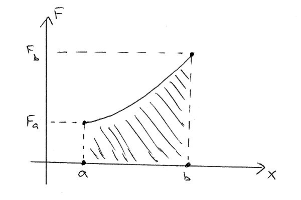

Why work done is area enclosed by graph of F v/s x on x Axis but not y axis.
Suppose we apply a force on object which is proportional to displacement as ##\vec f##=## \vec x##²then area enclosed by Force and displacement on x Axis is integral of ##\vec x##²but on y-axis it should be integral of ##\vec x##.from this I conclude that something is not correct in my reasoning but I can't figure it out.

Suppose a particle is moving along a line and it's force depends on position as ##\vec f##=##\vec x##² and we want to find work done by the force then we will find area under the curve and x axis.now my question is that why work is area under curve and x Axis but not y axis.

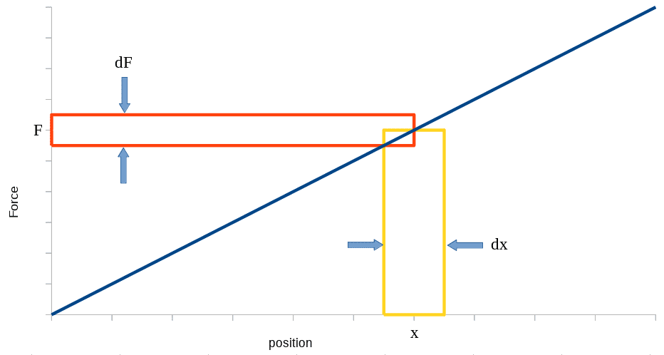

If you have ##y(x)## and if that function has an inverse ##x(y)## then the area between the function and the ##x## axis is ##\int y(x) \ dx##. The area between the function and the ##y## axis is ##\int x(y) \ dy ##
Work is ##\int F(x) \ dx## it is not ##\int x(F) \ dF##

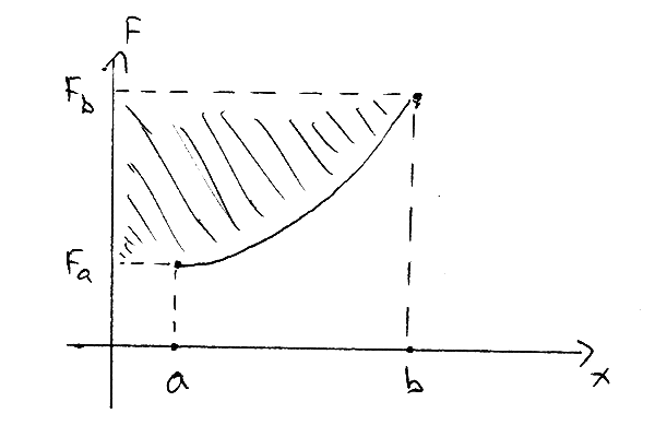

Are you asking, why does the work equal this area:
and not this area?
Then Dale's explanation fits.
To explain in other words what @Dale and @jtbell already said, work is a force ##F## times a displacement ##dx## by definition. A displacement is a length between two positions (##dx = x_2 - x_1##). The concept of force differential (##dF = F_2 - F_1##) times a defined position ##x## has no physical meaning.

Please note that this is no longer a physics question, but rather a mathematics question. It comes from the definition of the integral of a function, something that you should have come across in your calculus class.
If you have an expression where
y = ∫ f(u) du
and if you plot f(u) in the vertical axis and u in the horizontal axis, then y is the area under the graph! Notice that this has nothing to do with "work" or any other concepts in physics. Rather, it is the definition of what an integral is!
So when you apply it to work done, then when it looks identical in form to the above expression, ALL THE SAME RULES of integration also are valid there! In the example that you kept repeating, u = x, and f(u) = x2. So when you plot x2 on the vertical axis and x in the horizontal axis, then the area under the graph is the integral of that function of f(x) = x2.
