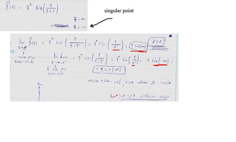

[tex]f(x)=\frac{e^{\frac{1}{z-1}}}{e^z-1}[/tex]
if we go [tex]z=0^+[/tex] f(z)=+infinity
if we go [tex]z=0^-[/tex] f(z)=-infinity
we don't have a limit here
so why its a pole
by my definition a pole is when [tex]f(z)=\frac{g(z)}{(a-z)^n}[/tex]
if g is analitical at g(a) then 'a' in th n'th order pole
but in my case there is no (a-z)^n representation
and i proved that there is no limit
in my exam i have much complicated functions
and i can't develop it into a series every time
i tried to solve this one strictly by the limit tests
where am i wrong in my limit test
where is my conclusion wrong
i was told that there is no +infinity and -infinity in complex functions
only infinity
but i have a solved question from a test which is solved exactly like it you said was wrong
and got full credit
maybe i am missing something here

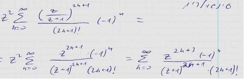

i tried to develop it into a series
if my development is correct how whould you continue to develop it
so we will get a series with only one z variable
i can't make a guess here its all has to be series with only one z in a certain power in order to make a conclution
Jose27 said:
$$\sin (z)$$ has an essential singularity at infinity, which means $$\sin \left( \frac{1}{z} \right)$$ has an essential singularity at $$0$$ (this is easy to check since the principal part of the Laurent expansion has infinitely many terms) and this gives that $$\sin ( f(z))$$ has an essential sing. wherever $$f$$ has a pole. Take $$f(z)= \frac{z}{z+1}$$ and the conclusion follows.
i understand why
but how we can take any function we want and say sin(f) has significant point
at the pole of f
like here
$$\sin ( f(z))$$
