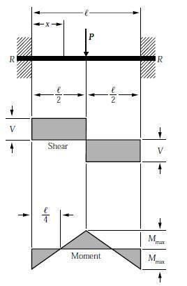

i have made a beam with both ends fixed. when I apply load at center then the ultimate load will be 8Mp/L=8fyz/L which came to be 440KN
My question is how to calculate the load at which beam starts yielding?

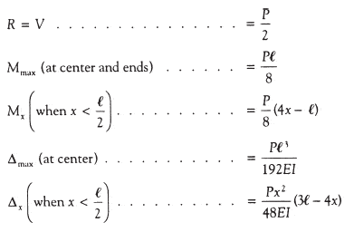

For a fixed-fixed beam with a central load P, the max. bending moment is MMAX = PL / 8, which occurs at the ends of the beam and in the center.

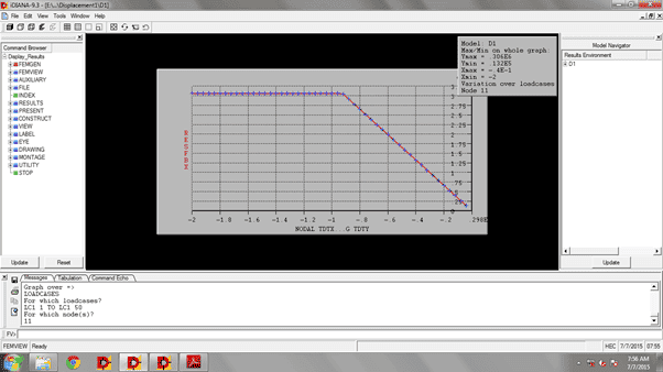

I have calculated the load at plastic hinge i.e 440KN
and the load at yield is 293.3KN
when i do nonlinear analysis it shows the maximum load of 306KN. why does not the software runs till 440KN since 440 is ultimate load where plastic hinge will be created? the graph below shows the maximum load 306KK. the graph is between load and displacement
